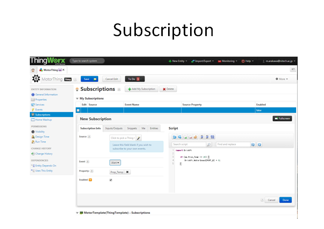

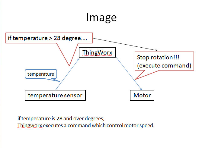

Now,i try to control speed of motor with temperature sensor and ThingWorx.
I attempt pictures which explains this thing.
Is it possible to control motor speed by entering the script of motor_control in the space of subscriptions of the Thing's Entity Information like second picture?

September 2, 2015
Hi
Thank you for the information.
I use BrickPi for connecting Motor and RaspberryPi.And,the motor is LEGO parts of Mindstorms.
So,the code methods which controls motor_speed is Python.The contents of command is that
if temperature > 28:
  BrickPi.MotorSpeed[PORT] = 0.
Should I write this code with Java and input this command in the space of Service Definition?

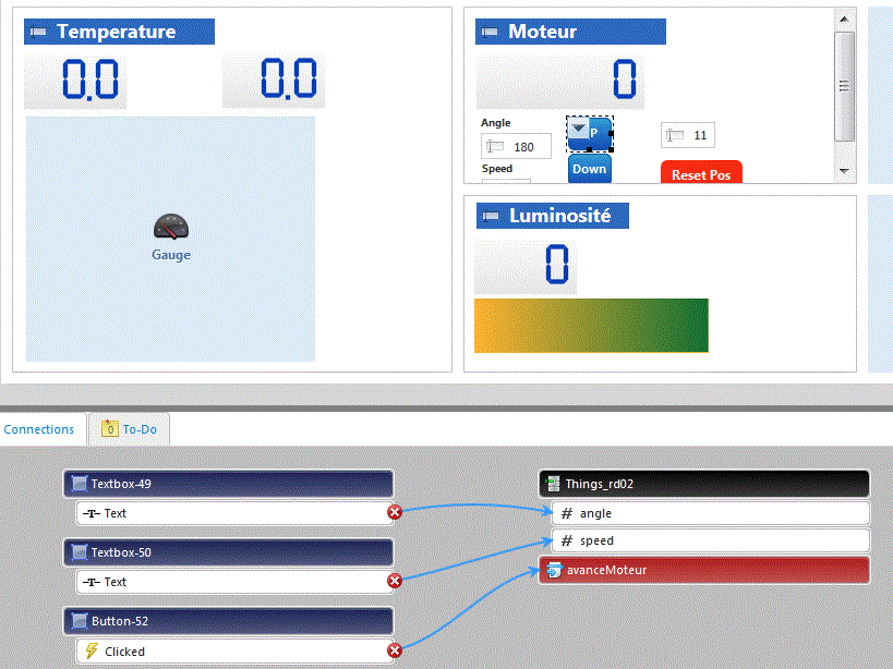

September 3, 2015
I did something similar with the TW  java SDK on a galileo board with a stepper motor.( similar to that one http://www.instructables.com/id/BYJ48-Stepper-Motor/)
1/ Create java methods to control motor rotation forward or backward i have 2 arguments ( angle, speed)
2/ Bind those methods as remote services
      @ThingworxServiceDefinition( name="avanceMoteur", description="Forward engine by x degrees")
     public   void avanceMoteur (  @ThingworxServiceParameter( name="angle", description="rotation angle", baseType="NUMBER" ) Double  angle,       @ThingworxServiceParameter( name="speed", desc
3/ Write logic either as event/subsciption as you sugestted  ( i recommend using a timer every x minutes instead  of a property changed event, so that you leave enough time for the motor to reacdh the desired position) , or in a mashup ( ie in the example below,  the motor control a mobile curtain ( up or down) that can be moved based on light and temp sensors to lower ambiant light)
