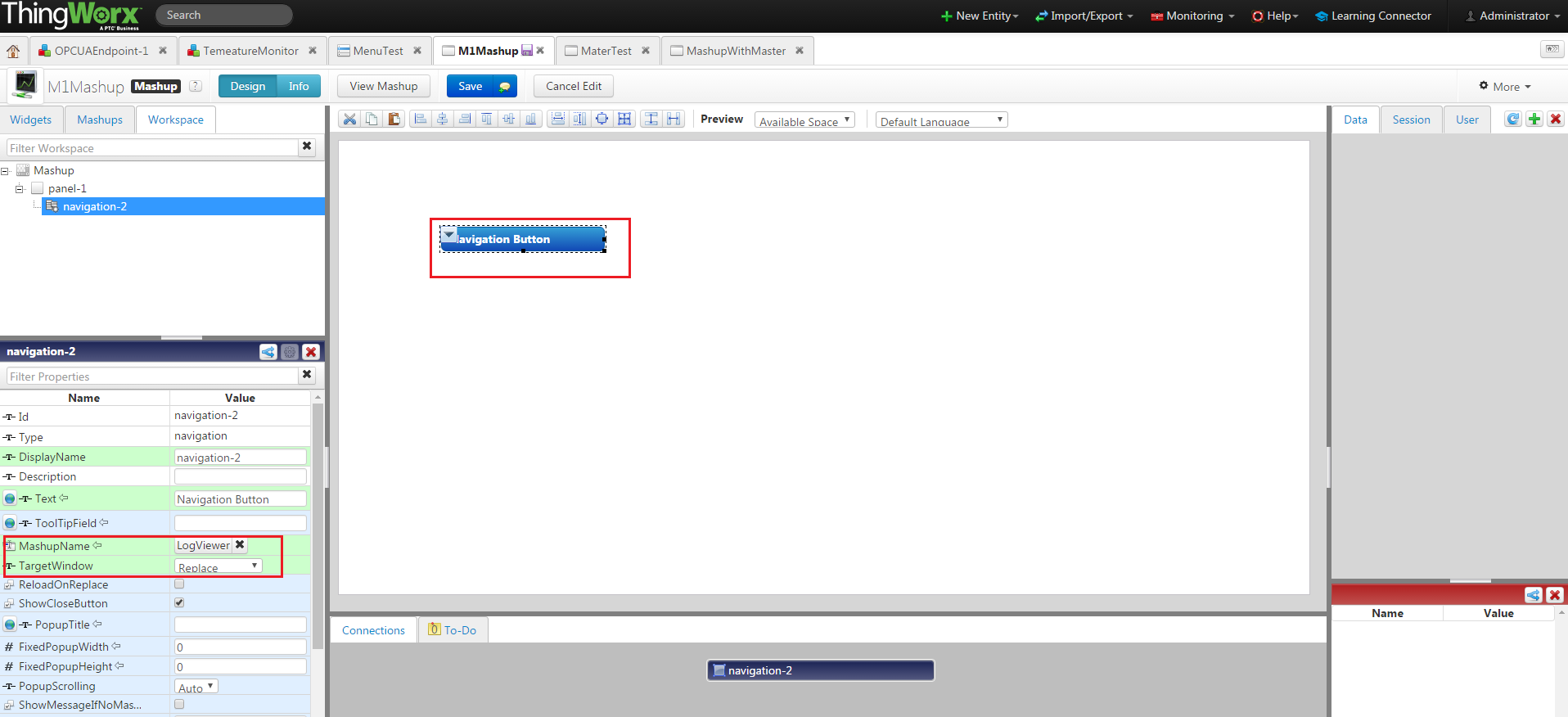

Best answer by liliu
Hi Lee,
I'd like to give you a sample of usering Menu on a master.

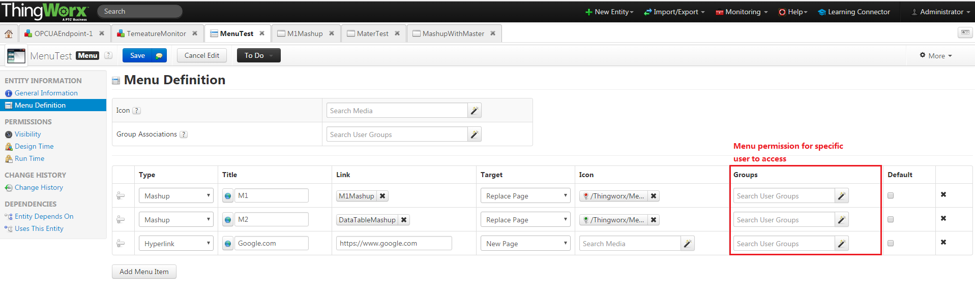

1. Create a menu. (https://support.ptc.com/appserver/cs/view/solution.jsp?n=CS205546&posno=5&q=menu%20permission&DocumentType=Article&Produ…)

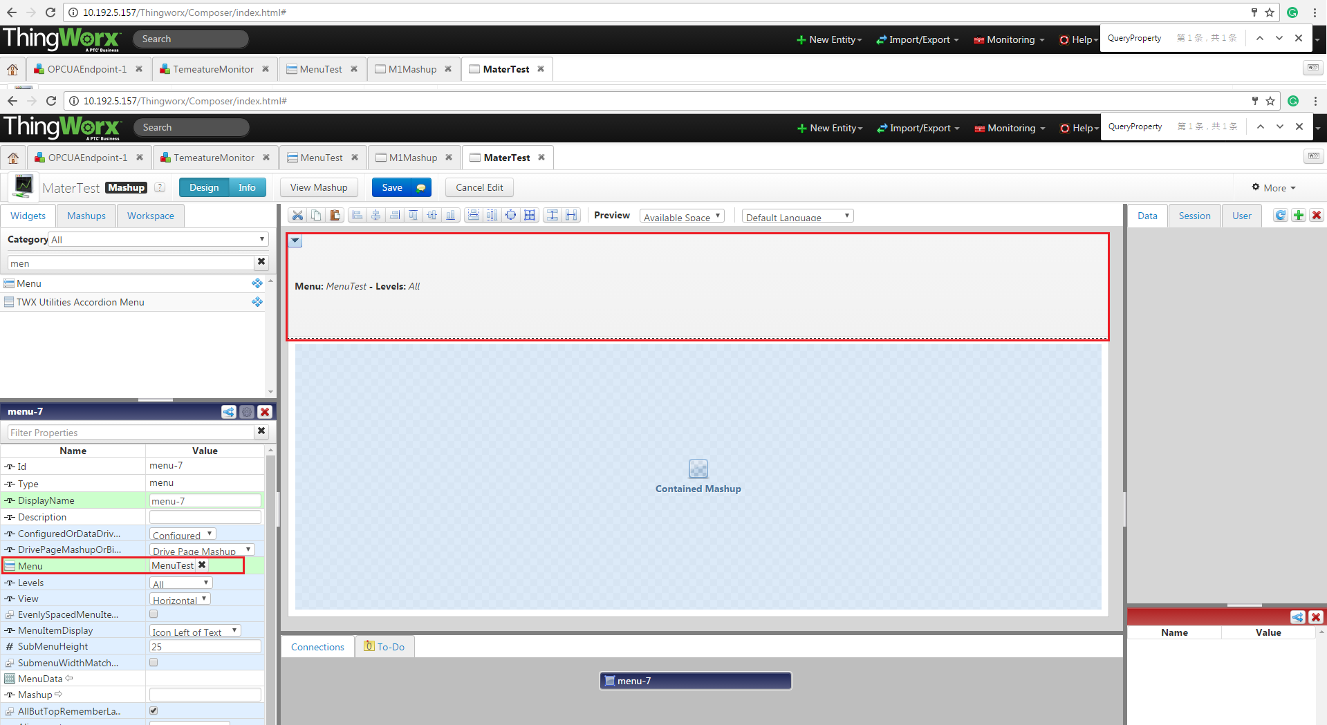

2. Create a Master and add a menu widget in the master design page. Bind MenuTest to menu widget

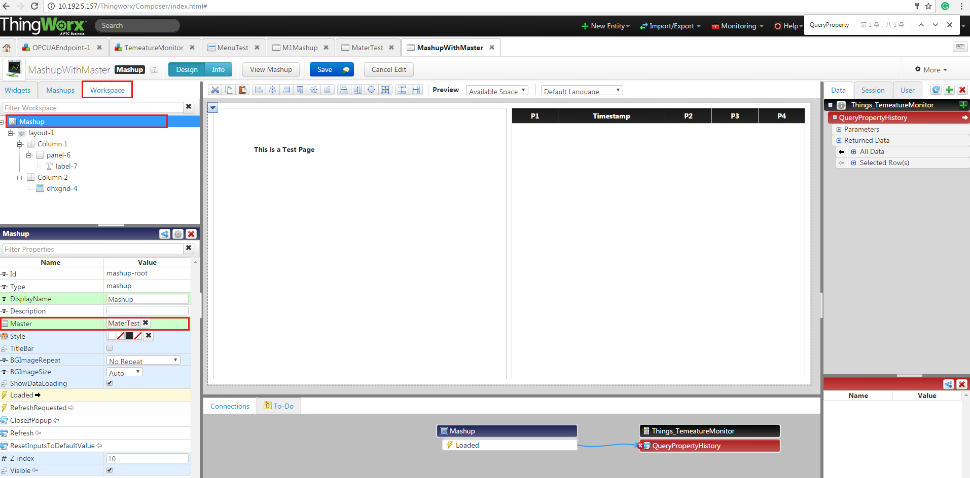

3. Crate another mashup that use step2's master as below.

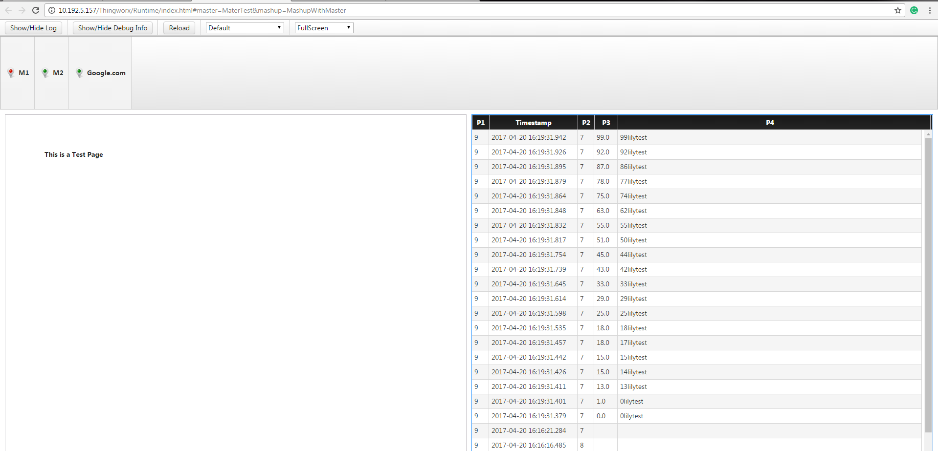

   run the mashup, you will see a picture as below

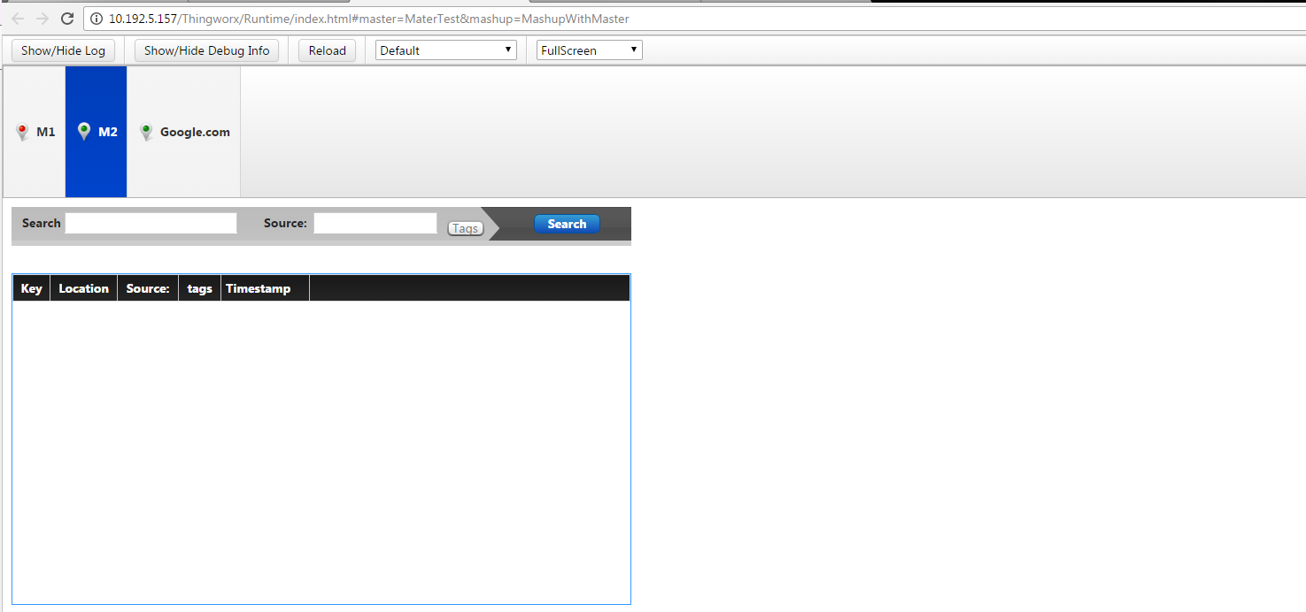

    Click the M2, the page will be redirect to another mashup.

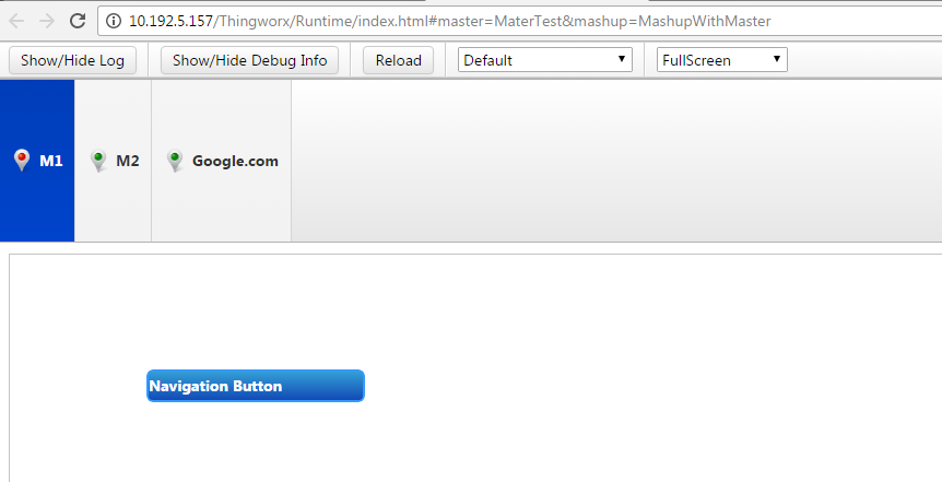

    Click M1, will redirect to a mashup that only have a navigation widget on it.
   click the button, it will redirect you to other mashup
That's all about menu, master and mavigation. If there are further concern, please feel free to let me know.

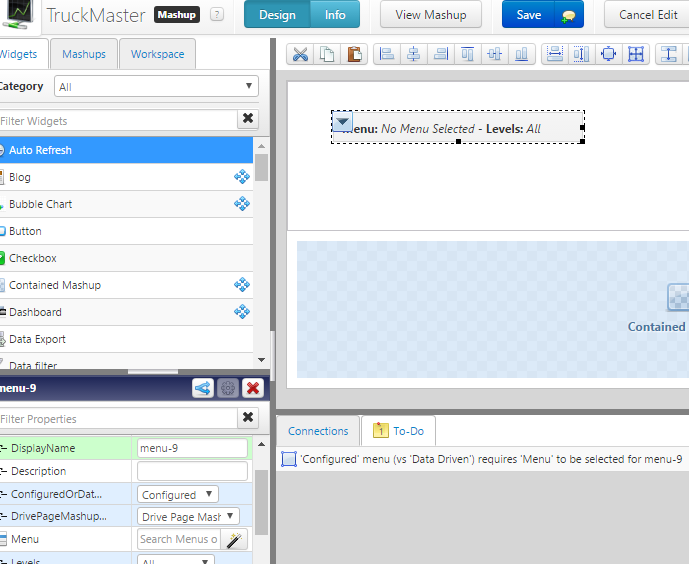

Hi Ji,
The Master is a separate entity type that you can create from the composer Home menu. Under the Visualization section, you'll fund Mashups as well as Masters Listed. Select the green "+" sign next to this to create a new Master. From the Master Mashup editor, drag and drop the Menu widget onto the editable area outside of the contained Mashup section. Once you save this, you can open the Mashups you wish to add the Master to by selecting the Mashup from the Workspace and in the configuration window, use the magic picker to select your Master.

April 20, 2017
Hello Saeed
Thank you so much!!!
But I have one more problem.
How to bind Menu  or  set target??
liliu5-Regular MemberAnswer
April 21, 2017
Hi Lee,
