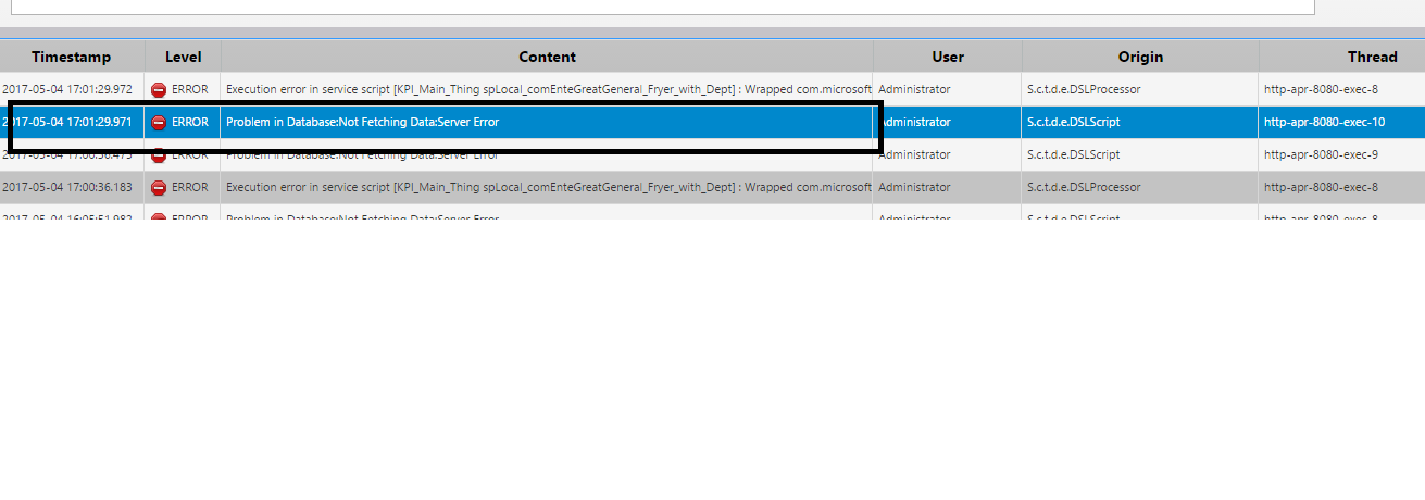

  I have written a custom service for getting the log details of my service. How to get the details of log as an alert from script logs when the mashup is loaded?
  How to create a basic alert in mashups?
Could anyone please explain me in detail?
