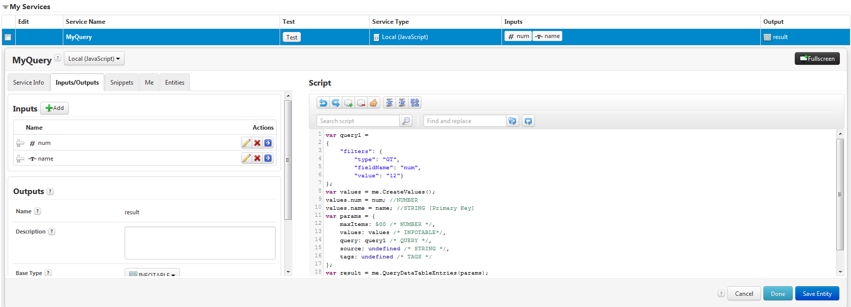

Hi Mr. Liang,
Here is my sample code:
var query1 =
    "filters": {
        "type": "GT",
        "fieldName": "num",
        "value": "12"}
var values = me.CreateValues();
values.num = num; //NUMBER
values.name = name; //STRING [Primary Key]
var params = {
maxItems: 500 /* NUMBER */,
values: values /* INFOTABLE*/,
query: query1 /* QUERY */,
source: undefined /* STRING */,
tags: undefined /* TAGS */
var result = me.QueryDataTableEntries(params);
For detail query infomation, please check here PTC.

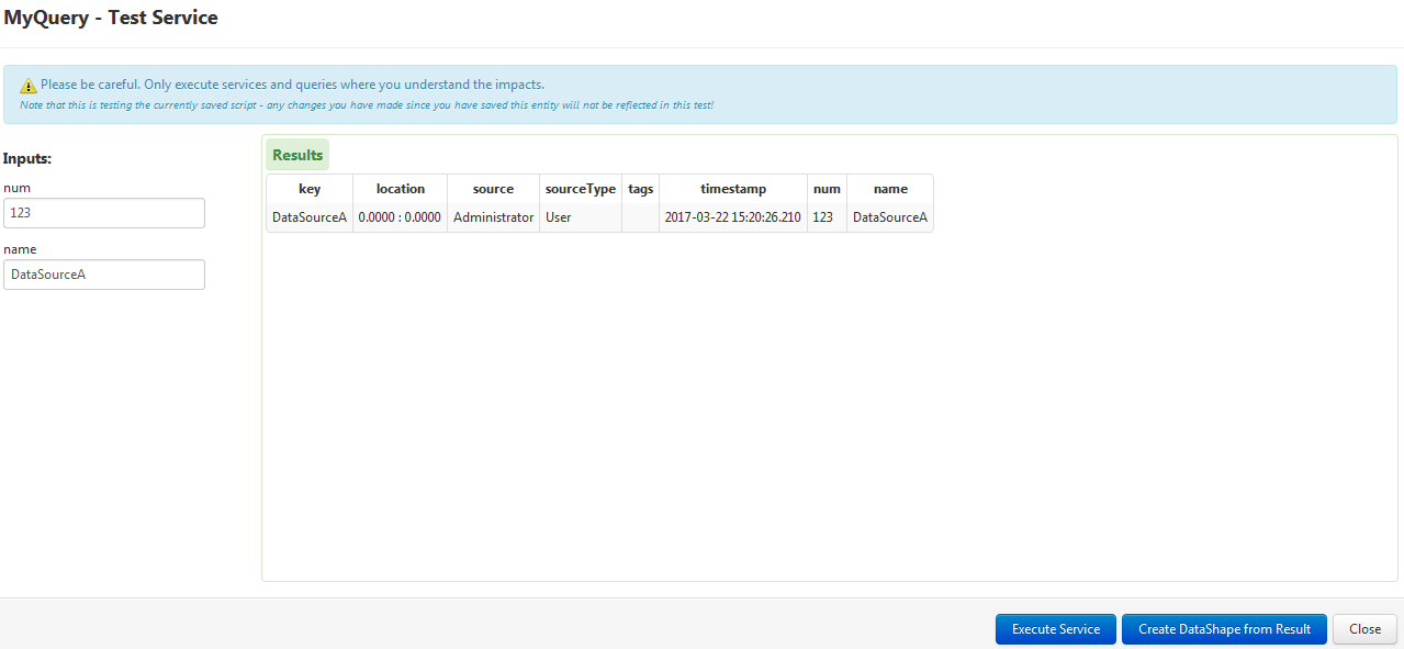

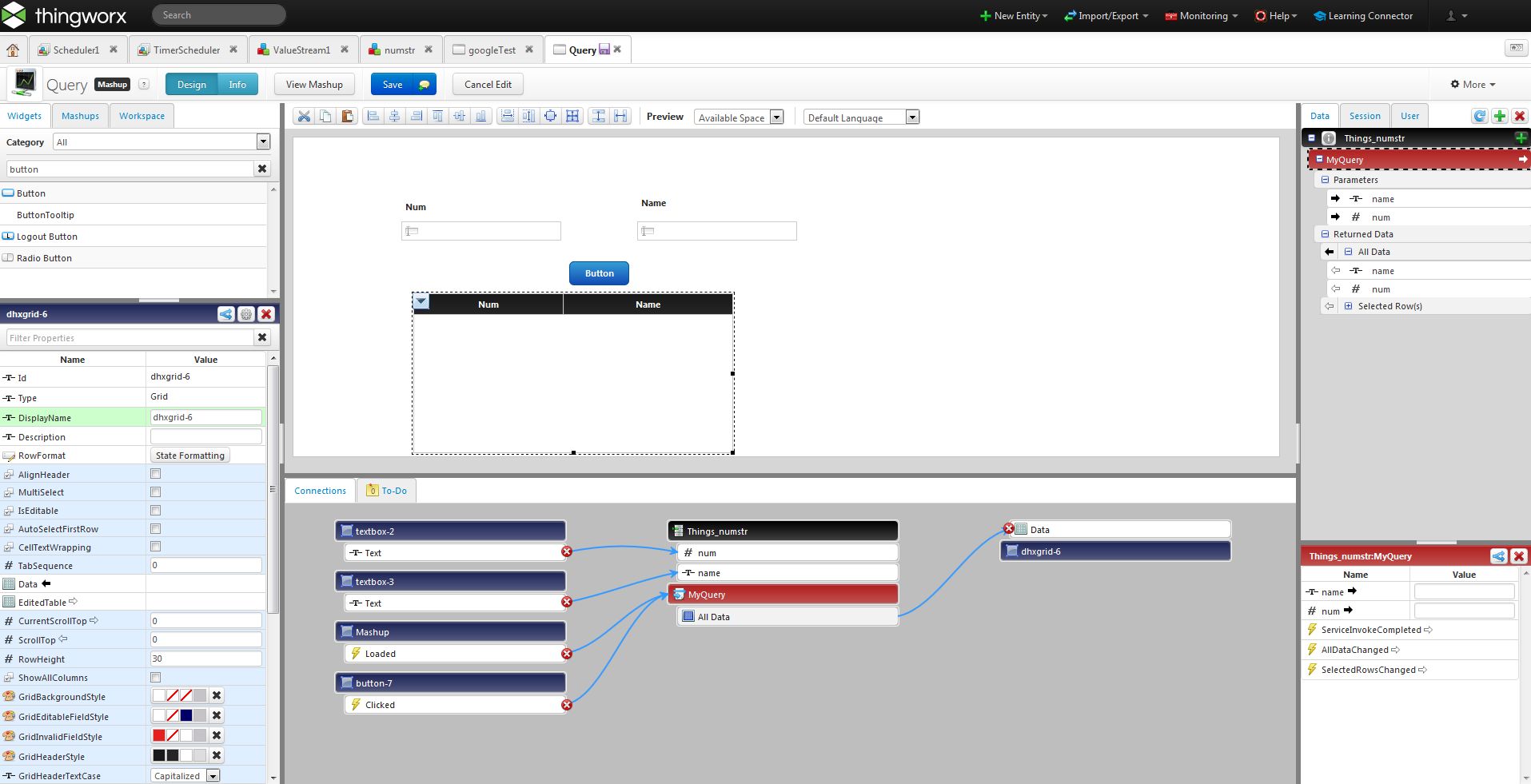

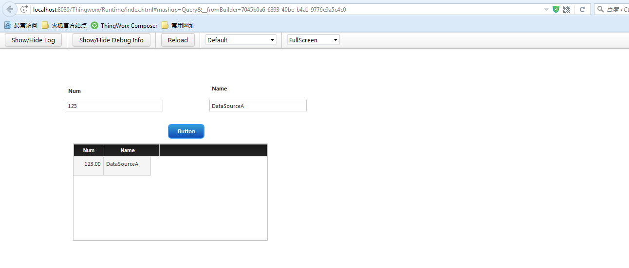

And the binding is like below screenshot:
