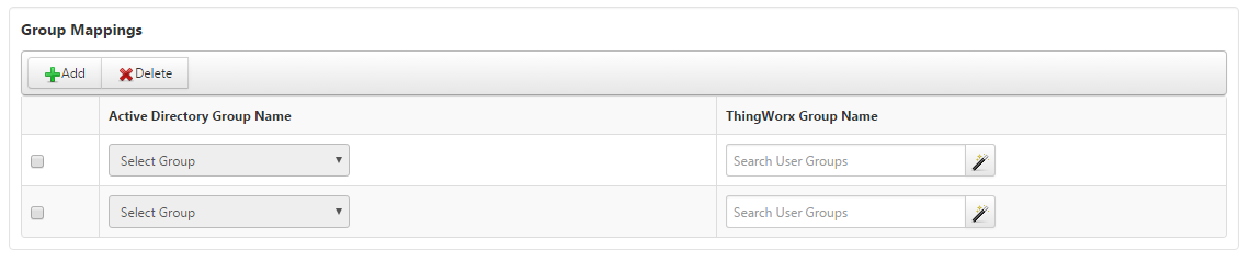

I am trying to map AD group with thingworx group. But dropdown for "Active Directory Group Name" is disabled and not allowing to select or enter anything.
How to enable this dropdown?

ankigupta5-Regular MemberAnswer
April 25, 2017
Lalit Prajapati​,
It works fine for me and I can select the user groups too.
Try running the GetDomainGroups Service and see if it returns the Group names.
If it returns an error; it means that your AD configuration is not correct. Try re-entering the Administrative Password.
Ankit Gupta

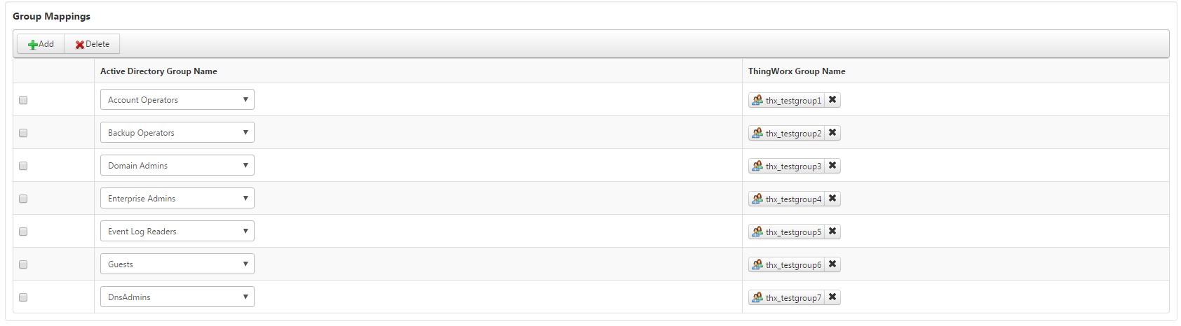

April 25, 2017
Hi Ankit,
It works for me too after executing the GetDomainGroups service.
Lalit Prajapati​
