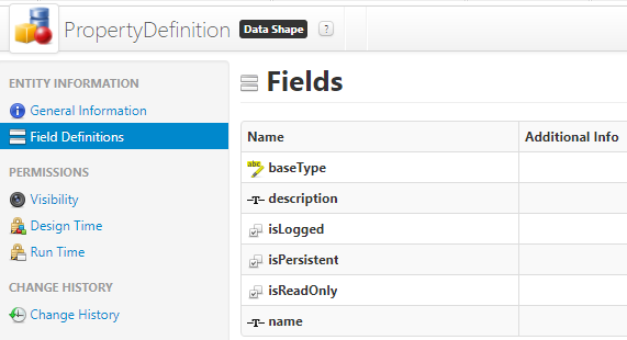

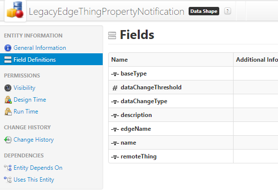

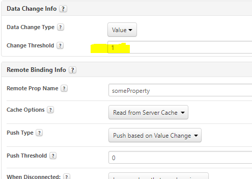

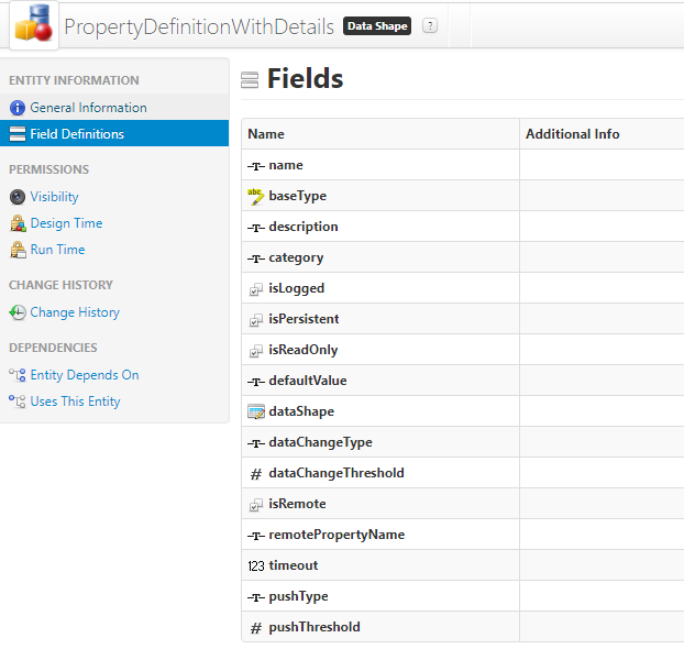

Hi there, I'm desperately trying to find a service which determines dataChangeThreshold value of a remote thing. I'd be grateful for your help!
GetPropertyDefinition() service output is limited.
There are some datashapes which have necessary fields, but I don't know what service is using any of them.

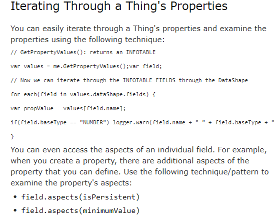

I believe this should get you going with the pattern to access the aspects Iterating Through a Thing's Properties

Hi Mnudel, since these values are part of Thing's Aspects have you tried Class Aspects and Class AspectCollection that should return array of collection. Plus this enum DataChangeType
Not sure if this helps
