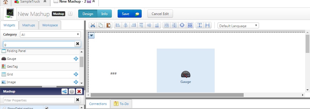

look, my Thingworx Composer doesn't has google map widget
i installed ThingWorx-Platform-H2-7-3-1, Tomcat 8.0.36, postgreSql9.4
why i can't find google widget? why this happen to me plz help me
thanks, have a good day
Best answer by posipova
Hi please download it here https://marketplace.thingworx.com/Items/google-widgets
To install click on Import/Export on the top of your composer screen (top right), then click on Import Extensions and import the zip file.

Hello seonho Cha​,
Please note, that Google Widget isn't a standard and OOTB Thingworx Widget. It's an Extension, that can be found on the Marketplace:
https://marketplace.thingworx.com/Items/google-widgets​
After downloading, just import to Thingworx and refresh the Composer.
Hope it helps.
