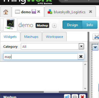

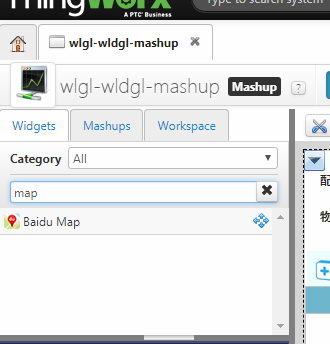

As the title, I want to insert a new widget in my mashup. When I create a test mashup demo, I found that I can't search the widget I want to insert my mashup such as map. But I can see the map in mashup of other project. So I want to know the method to new a weight or the position to find the map widget.
Now I use Composer7.0.
Please help me. Thank you.
   Search map in my mashup widgets as below:
   And Search map in other's mashup widgets as:

Hi Xinyan, have you installed the Baidu Map extension to be able to use that in your Mashup? If you haven't already installed the map please navigate to the ThingWorx Marketplace and download the Baidu Map extension.

Hi Sushant, thank you for your great support, I got it.
