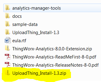

HiZhu Wenxi​,
Is Your ThingWorx core and Analytics Running OK? You can find the Upload thing folder in the Analytics Extension zip Which you have imported in ThingWorx core. From that folder you need to run install.bat with administrator rights after that you will able to upload data in to builder.
Highlighted one is the Upload Thing folder. Unzip this and run the bat file.
Do let me now in case of any question.

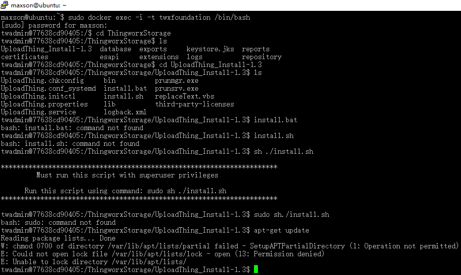

zhuwenxi12-AmethystAuthor
October 27, 2017
My Thingworx foundation is OK, and I have imported 'Thingworx-Analytics-8.0.0-Extension.zip' and works now.
But my Thingworx is running at docker, not windows, so I need to install UploadThing into Thingworx foundation docker image.
I failed to install it. The command I run shown in the captured sceen below.

After installing UploadThing on the host, and make some configuration according the article. It works now.
Thanks for your help.
