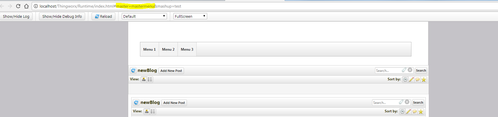

I need a service that returns the name of  master in use, but I did not find a function in the snippets that could return that result.
20-Turquoise
July 18, 2017
You cannot get the binding programmatically; the only way I can think of, out of the box, is to look at the URL query as described in my past reply.
20-Turquoise
July 18, 2017
You could generally look at your URL query to see the name of the master mashup:
