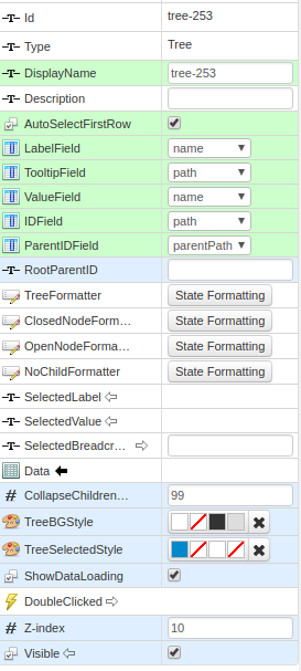

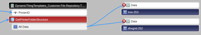

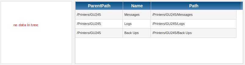

thanks for the quick response. I took your advice, but am having problems getting the result to display in the tree widget. I wonder if you can see anything obvious? I use the same service to populate a grid widget (for debug) and a tree widget. The service is just a wrapper service around ListDirectories and I believe the data returned is correct.

I think I have the tree widget configured correctly, but don't see any data.
Can you see anything obvious that I am doing wrong. I have so much trouble with tree widgets.

December 4, 2017
On your service, add this fake row:
result.AddRow({ path: yourRootThingFolderPath, parentPath: "", name: "/" });
