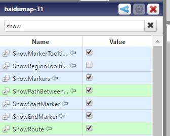

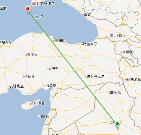

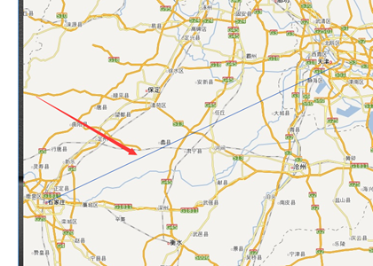

     I can't display the starting position and the end position when using the route function of the map. How do I set it?

It seems that you can draw the line using the Route in Map, so you might be asking for the Start and End location marker.

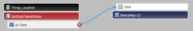

If you are binding data to Data in Map, and configure it like this
But the Markers could not show in the Route and Region.
And if you are using the same set of configuration: ShowPath, ShowStartMarker, ShowEndMarker,  you can still get what you want.

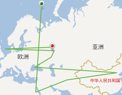

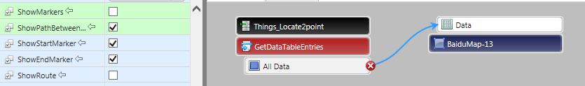

     I've tried to set these three properties before,It didn't work out!
     Is there any requirement for the data?
June 22, 2017
4 properties from the ShowMarkers to ShowEndMarker only respond to Data input,
Only ShowRoute responds to Route input field in the Map widget. And you should select a input for Location field
