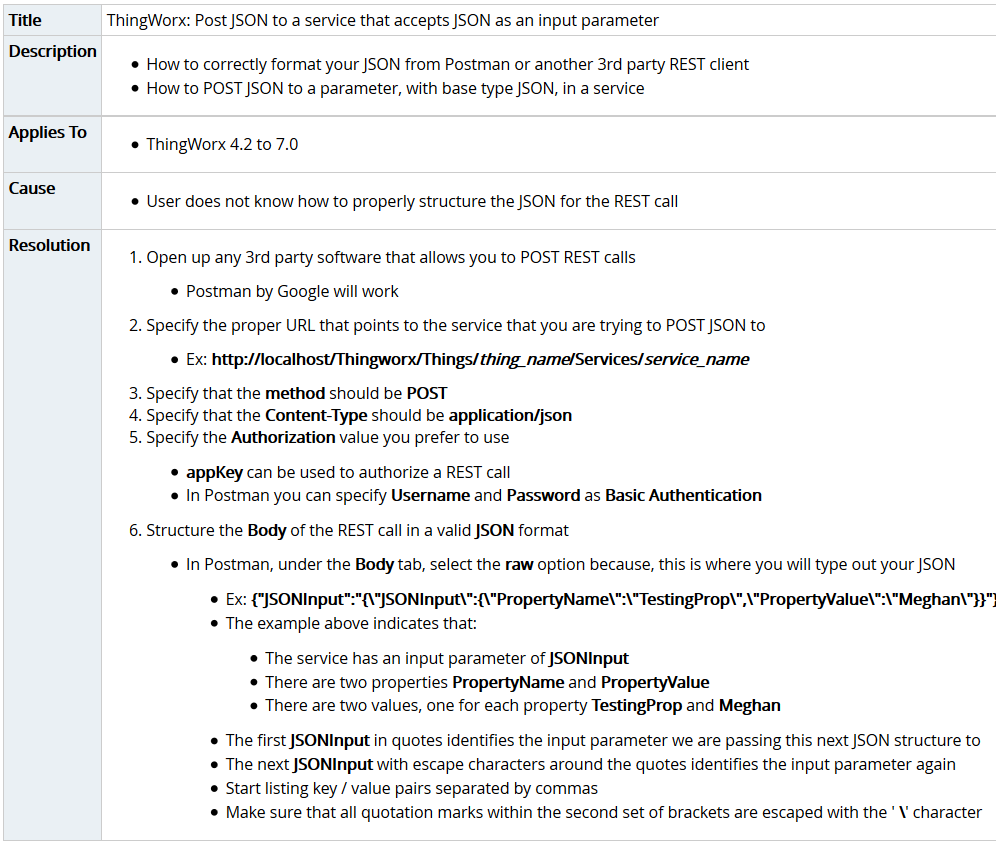

Hello everybody,
I created a custom service with a JSON Input called "Data". I am trying to test this service via Postman.
Data will contain something like this:
"var1":5,
"var2":10
"var1":5,
"var2":10
Can someone tell me how i correctly pass this to Thingworx? So how do i have to format my body in postman? And in Thingworx Javascript do I have to parse the json first or is it already passed as i specify the input as json.
Thanks. I think the documentation on these things is really sparse

Hi Nicolas Jourdan​,
tl;dr
To make it easy - if you need to pass an array in a format of JSON, just add a JSON type input parameter e.g. "data".
This array can be accessed by refering to "array" property, e.g.:
data.array.length;
data.array[0];
data.array[0].var1;
data.array[1].var2;
To pass that data from Postman or other tool, you need to pass as a body of the POST request:
     "data": [
               "var1": 1,
               "var2": 2
               "var1": 3,
               "var2": 4
Please, remember to set a Header Content-Type: application/json and authorize with Application Key. If you expect any response, you can also set a Header Accept: application/json (if this format fits you).
Hope this helps.
J.

Please check following article for details https://support.ptc.com/appserver/cs/view/solution.jsp?n=CS213601&lang=en_US
Added a screenshot here for reference:

Thanks a lot its working now!! I also found the article posted by Ankit Gupta​ but it didnt work for me with the escaped quotation marks
