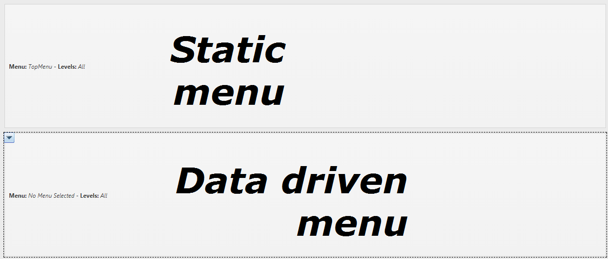

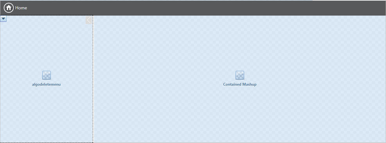

I have the master page (below image for your reference)
Menu contained mashup has two one static and other is data driven (below image for your reference)
both uses the same contained mashup in the master to load there respective mashup, for static mashup if i associate master in the mashup i am able to get it. I am confused with the data driven mashup and also i have to load it to the same contained mashup area of the master.
It will be of great help if you can give an example/explain.
