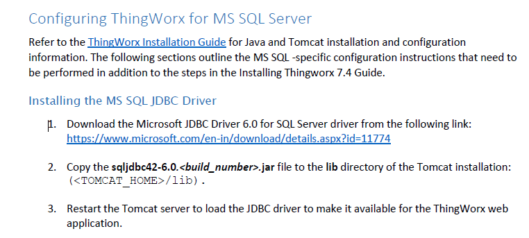

I am facing error while doing local setup "ThingWorx 7.4 with MSSQL database" ERROR:-017-06-08 17:02:39.358+0530 [L: ERROR] [O: c.t.s.ThingWorxBootstrapper] [I: ] [U: SuperUser] [S: ] [T: localhost-startStop-1] [message: Failed to create com.thingworx.persistence.mssql.MssqlPersistenceProviderPackage. Cause was due to 'null']
2017-06-08 17:02:39.359+0530 [L: ERROR] [O: c.t.s.ThingWorxBootstrapper] [I: ] [U: SuperUser] [S: ] [T: localhost-startStop-1] *** Web Application STATE is being set to ERROR! ***
Please assist me how i will remove this error.
Best answer by dupatel
Jitender Singh​: I faced the same issue and it seems you have missed the step of placing the JDBC jar file as mentioned in the installation guide
Copy the sqljdbc42-6.0.<build_number>.jar file to the lib directory of the Tomcat installation: (<TOMCAT_HOME>/lib).
Please refer document : Getting Started with MS SQL Server and ThingWorx for complete details.

Jitender have you verified if the MS SQL's schema is setup correctly and you have all the required schema generated from the script?

In addition to Sushant's questions, please ensure your tcp/ip is enabled  and the port you configured your mssql with is open. Also verify the password in platform-settings.json file.
