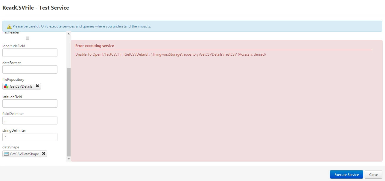

I am getting access denied error while reading CSV file.
Steps Perform to reach this,
  1. Created a Thing
  2. Created a DataShape
  3. Imported CSV extension
  4. Click on Magnifier
  5. Go to services
  6. Click on "ReadCSVFile --> Test"
  7. Copied CSV file to "ThingworxStorage\repository\GetCSVDetails"
  8. Fill below items
    1. fileRepository
    2. dataShape
  9. Click on "Execute Service"
After that I am getting Error as
"Unable To Open [/] in [GetCSVDetails] : \ThingworxStorage\repository\GetCSVDetails (Access is denied)"
Attached is the screen shot.

Firstly you check the csv file resides in the repository thing you created using the service  GetFileListing to male sure
Then to test ReadCsvFile you need to set correct path .. i think you are giving the whole path as like
repository/Repositorything/store  instead you give path  /store/Book6.csv and give it a go !
Hope this helps !
Hope this helps !

Hi Nilesh,
Thanks.
Now I am able to read my csv file.
