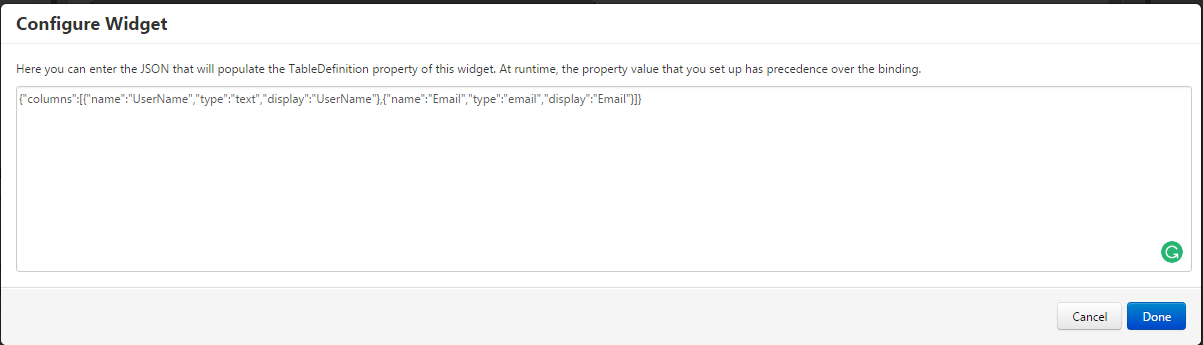

I found that the Done button was not responding,When I tried smartgrid widget。

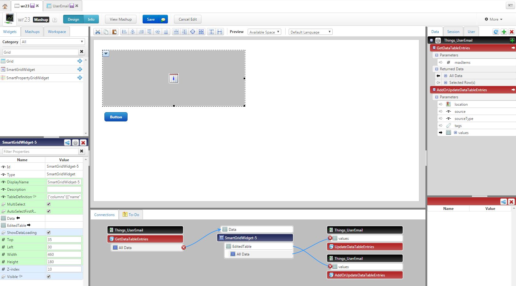

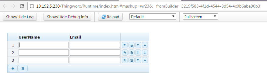

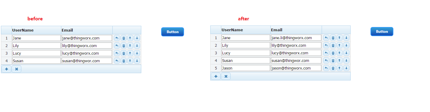

For my example:
1. Create a DataShape named UserEmail
2. Create a DataTable named UserEmail and bounded with DataShape "UserEmail"
3. Create a Mashup and bind things as below
So far, availavle API for DataTable only AddOrUpdateDataTableEntities. If you need the delete function works, we many need customized a service and combin DeleteDataTableEntities service.

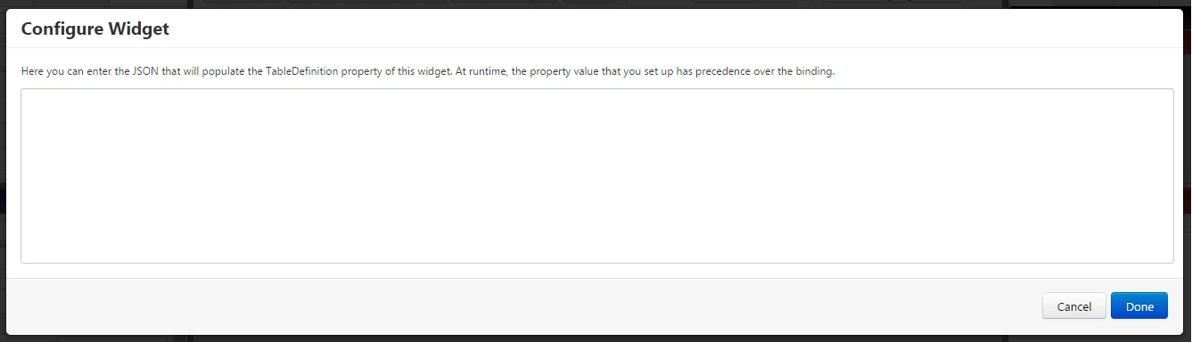

What exactly are you trying to do here? Have you tried entering a value into that box and then hitting Done?

Evidently, you have to create a valid JSON with columns array, which contain quoted names of keys and with only double-quotes everywhere.
Something like this: {    "columns": [       { "name": "User", "type": "text", "display": "User"},        { "name": "Gate", "type": "text", "display": "Object"},        { "name": "Permanent", "type": "text"}  ] }
