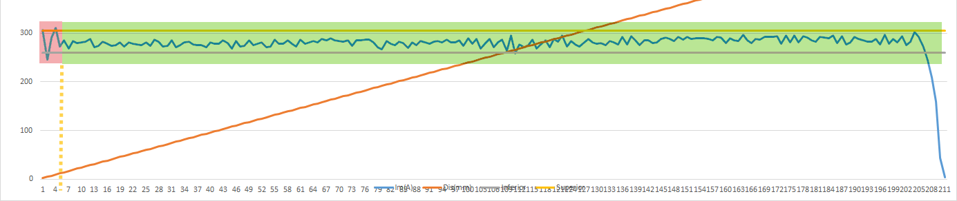

Hello All,
I am creating an application where I monitor a Current data stream and in my case in the begging of the process the property has an overshoot that should not be considered (in Red):
I thought about doing a condition with the orange line ( if >7 then Alert). I know I could create a flag and set it but I'm curious to know if there is something that could be done using the Alerts capability.
Any thoughts?
Cheers
Ewerton
Best answer by emoreira
I just tested it and it works!
I subscribed to the property and added this code:
var params = {
  persistent: undefined /* BOOLEAN */
(eventData.newValue.value <15.0 || eventData.newValue.value > 490.0)? me.DisableAllAlerts(params):me.EnableAllAlerts(params)
Any other feedback is appreciated!

Sorry, I am confused. You want an alert to fire when what happens exactly?
emoreira14-AlexandriteAuthor
November 23, 2016
I want the alert to fire when the reading exceeds the limits but not in the begging in the process because it is known that this overshoot makes the property to go over the limit and it is not a problem.
Cheers
Ewerton
