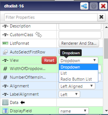

The list widget provides you with three options to get the the entries.
Hope this helps.

dmalika1-VisitorAuthor
December 11, 2017
Hi Saran,
I need a "Combo Box" which will enable the user to select multiple items from the drop down list at one go. Please let me know if there is any work around for this.
This "Combo Box" is available in previous version, but not in the latest version.

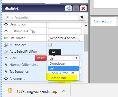

posipova20-TurquoiseAnswer
20-Turquoise
December 11, 2017
Which exact version are you using? I just checked 8.0 and 8.1 - combo box is there.
December 12, 2017
Hi Polina Osipova,
We are using 8.0.0 b11. Is it because of beta11?
