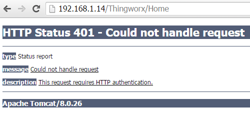

I am having a problem making the Postgres SQL works with Thingworx. I want to install a fresh Thingworx server with PostgresSQL. I followed the instructions from https://support.ptc.com/appserver/cs/doc/refdoc.jsp?p=browse_results&Product=ThingWorx&Release=&DocType=&Role= to create the database in ThingworxPostgresqlStorage folder and create another folder-ThingworxPlatform to put the modelproviderconfig.Json file. I can see that the database is created in pgAdmin III.
I deployed the Thingworx.war for Postgres but could not connect to Thingworx server. I got the error page as shown below. It seems like the database is not connected.
Can somebody help?
Thank you.
Best answer by pcheah
I know where is the problem, the problem is with the directory created to store the database.
In the manual, it is written "thingworxpostgresDBSetup –a postgres –u thingworx –l C:\ThingworxPostgresqlStorage", but by default, Thingworx is link to C:\ThingworxStorage. To solve this, I just changed the cmd script to "thingworxPostgresDBSetup –d thingworx –LC:\ThingworxStorage", it works!
note: Remember to set permission to modify this folder (C:\ThingworxStorage) or you will encounter Permission Denied error.

In your case, can you please tell me if the database were created in the directory "ThingworxPostgresqlStorage" or in "ThingworxStorage".

ThingworxStorage is created instead.

Is there a file PG_9.4_20... in your ThingworxStorage folder ?

I habe the same problem.
A folder with the name PG_9.4_20... exist in the folder ThingworxStorage.
If I use the SQL create statement from the file thingworx-database-setup.sql.
I get from PostgreSQL this error "FEHLER: konnte Verzeichnis „pg_tblspc/27596/PG_9.4_201409291/28056“ nicht erzeugen: No such file or directory"
If I remove the tablespace thingworx and use the standard tablespace I get no error.
Have you any ideas why the problem is the own tablespace?
