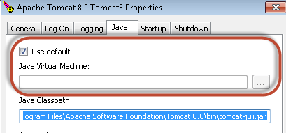

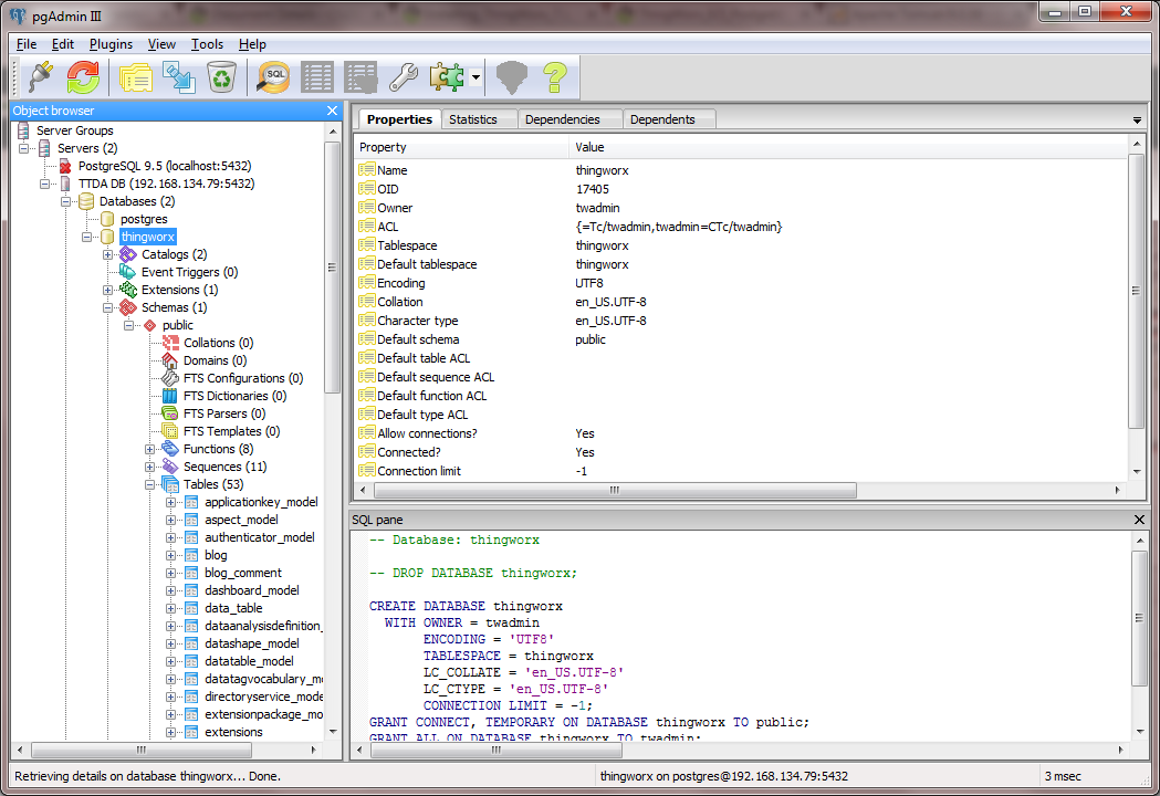

I am trying to install TWX 7.1 with postgreSQL DB on separate server. I've managed to install it and run with Postgres 9.3 but I've realized that it is not supported (data sql schema was not loaded correctly) so I've installed 9.4 and started from scratch. Currently I am not able to start Thingworx from totally unknown problem.
platform-settings.json:
        "PersistenceProviderPackageConfigs": {
                "PostgresPersistenceProviderPackage": {
                        "ConnectionInformation": {
                                "jdbcUrl": "jdbc:postgresql://192.168.134.79:5432/thingworx",
                                "password": "password",
                                "username": "twadmin"

PgAdmin screenshot:
Any ideas what can be wrong? Anything else to check? I've restarted machines, make the whole procedure several times, always the same result.

Hi Jacek, is the JDK updated after it was first installed when configuring the ThingWorx and along with Apache Tomcat? Could you confirm if the path to the JDK bin is same as defined in the Apache Tomcat Config utility under the Java tab
I think i had the same issue as you having right now, because the path to the JDK changed when i updated the JDK. Since then I check the Use Default, instead of providing the JDK path under the JVM path and set JAVA_HOME in the Environment path.

Hi Sushant, I am not using Windows nor I have any GUI for my system, but from the logs I can see that Tomcat is using my latest Java installed (however JRE, not JDK):
Java Home:             /usr/lib/jvm/jdk1.8.0_92/jre
JVM Version:           1.8.0_92-b14
JVM Vendor:            Oracle Corporation
Moreover, I was able to run Thingworx with the same Java and Tomcat settings but with Postgre 9.3.
It just stopped working when I switched to 9.4
