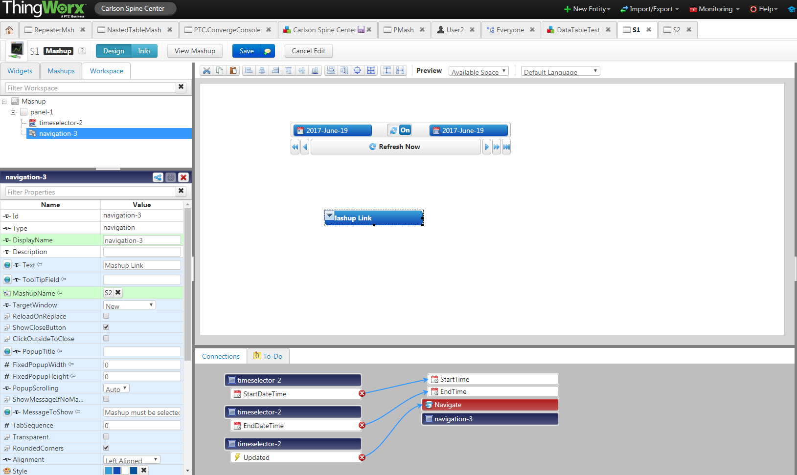

Hi All,
I need to have for different mashup the same time period (I'm using a TimeSelector).  If I will change the period inside one Mashup the same change will be do in the other mashups.
Is is possible This ?
I have tryed with Session parameters but it does not work.

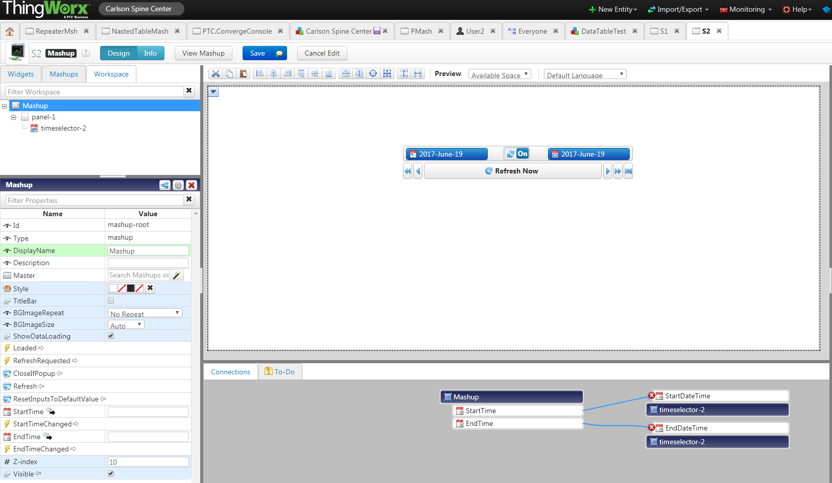

Hi Bologna,
I am not sure how do these three mashup display for you? Are they contained mashup? Or do you use naviation widget to open the other three mashup?
I did a sample for naviation mashup to transfer the timeselector data to another mashup.
1. Create the naviation mashup named s2, in this mashup, create two session parameter, and bind it to a time selector widget for start and end time.
2. Create another mashup named s1, add timeselector and naviation widget for this mashup
     Please set the Navigation attribute:
     Visible: false
     MashupName: S2
3. Bind TimeSelector's StartDatTime and EndDateTime to Navigatgion.
4. Bind TimeSelector's update event to Navigation.
Should you have any further concern, please let use know.
Best Regards,
Lily
