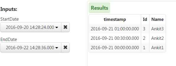

Best answer by ankigupta
Screenshot of result:

Hi Dimitri Bologna​,
I just tested this scenario on ThingWorx version 7.4 and it works fine.
Here is my code:
var params = {
    oldestFirst: undefined /* BOOLEAN */,
    maxItems: undefined /* NUMBER */,
    sourceTags: undefined /* TAGS */,
    endDate: EndDate /* DATETIME */,
    query: undefined /* QUERY */,
    source: undefined /* STRING */,
    startDate: StartDate /* DATETIME */,
    tags: undefined /* TAGS */
// result: INFOTABLE dataShape: "undefined"
var result = me.QueryStreamData(params);
Could you please confirm the ThingWorx version you are on?
April 21, 2017
Hi Ankit,
many thanks for your answer.
I'm using the Thingworx 7.4
Now the service is working.
Maybe I had inverted the dates.

April 21, 2017
Things to check: select start date and end date in correct order. Sometimes end date variable show before start date and we select them incorrectly.
Output of the service is an infotable.
ankigupta5-Regular MemberAnswer
April 21, 2017
