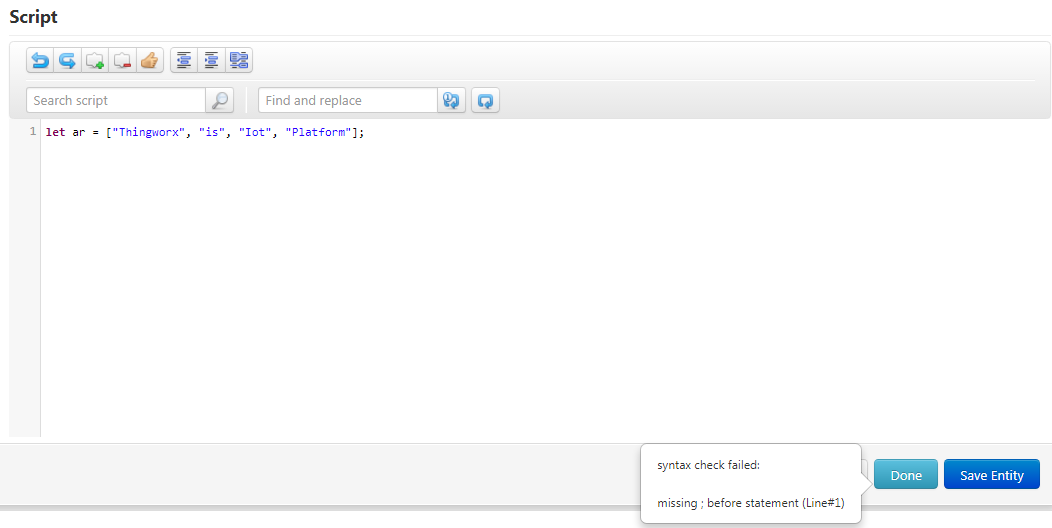

First, As I have known, Thingworx Server-side script uses Rhino 1.7R4 which is based on Javascript 1.7. Then the script should support the functions of Javascript 1.7 such as "let".
But when I use the "let" statement in the script, it comes out "Sytanx Error". I think Rhino has no problem on that, then is this problem of javascript syntax checker of Thingworx?

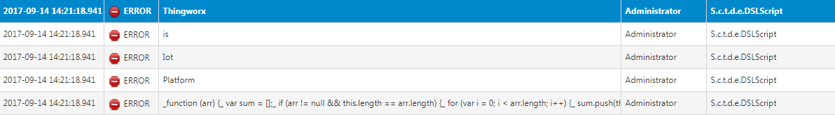

Second, This is similar problem with above. If I use "for ~ in" statement on Array, then It makes the output weird.
Example codes is below.
1) Syntax Error of "let"
2) Error of "for each ~ in". it outputs unknown sentence starts with "_function".
If anybody knows this kind of problems and reasons, please reply. Thanks.
Best answer by CarlesColl
On TW services there isn't much difference between var and let, as there "isn't" global scope ( it's just the service context which starts and ends on service calls ), then the difference between booth are minimum on a service scope.
To iterate arrays as far as I know:
// -- Calls myFunction(item,index) for each array item
myArray.forEach(myFunction);
// -- Iterates over each array item and sets item with it's value
for each(item in myArray) {}
// -- Iterates over each array item and sets index with the item's index on the array
for (index in myArray) {}
// -- Of course the "length" way
for (var i=0;i<myArray.length;i++) { }
* On all this samples the only one which can "simulate" let behaviour it's the first one, as all variables in myFunction will be local to myFunction, all the other ( the item, index and i samples ) you will have the variables defined out of for loop scope.

Thanks for your quick reply.
So as I understand, Thingworx script language doesn't follow ECMA-262 standard not completely. It has own customized version of Rhino. Am I right?

If I log the length of the array lilke:
It makes the length of 'ar' as 5 which originally 4.
And If I output the elements of array.
It includes weird value on last index such as:
September 14, 2017
I've tested your exact code and I get 4 not 5, I've tested it on 6.5.13 and 7.3.9, on which version are you testing it?
And yes it's a customized version of Rhino
