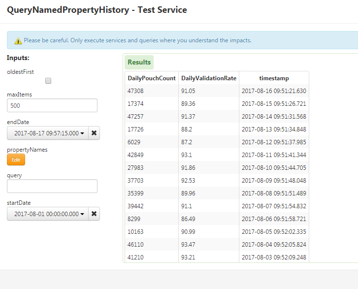

I am trying to graph the results of a QueryNamedPropertyHistory service call.
When I test the service on my thing, the infotable returned looks like this:
The data points have identical timestamps because they are added to the stream in a custom service with the same date/time object passed in the params. So there are not duplicate entries in the infotable.

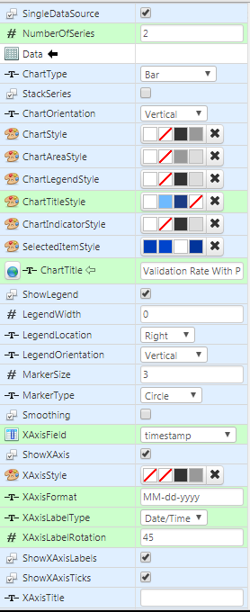

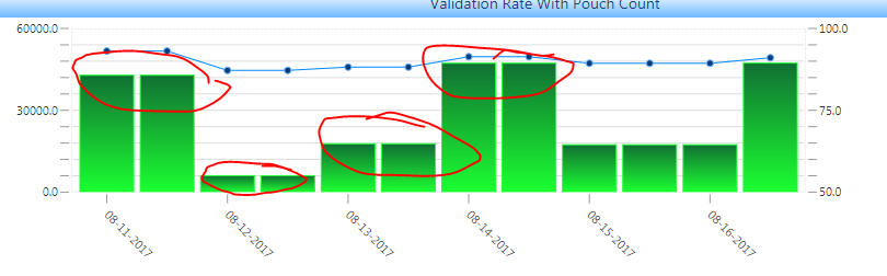

But when I bind the results to a label chart in a mashup, I get duplicate data points:
Does anyone know why this is happening? The data values and timestamps are exactly the same in the duplicates. I'm wondering if I just have a weird setting that I need to change.

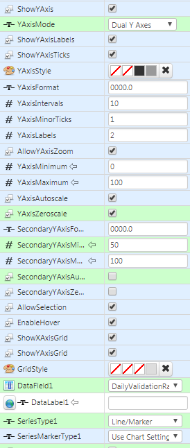

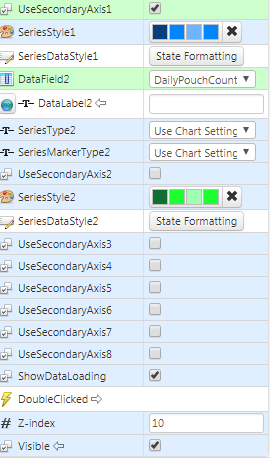

Here is a screenshot of my property settings:

Just to double check can you put the data in a grid as well next to the chart to make sure you aren't somehow receiving those entries in the mashup, even though the service seems to not be doing it.
jmay11-VisitorAuthorAnswer
August 17, 2017
Pai,
Your suggestion made me have an epiphany without even implementing it. I realize that this service is returning other properties that weren't being updated with the same date/time stamp. So just because I don't use them in the graph doesn't mean there won't be rows for each timestamp... if that makes sense. Anyway, the solution is to make sure those are the only two properties being passed as parameters for the service call.
