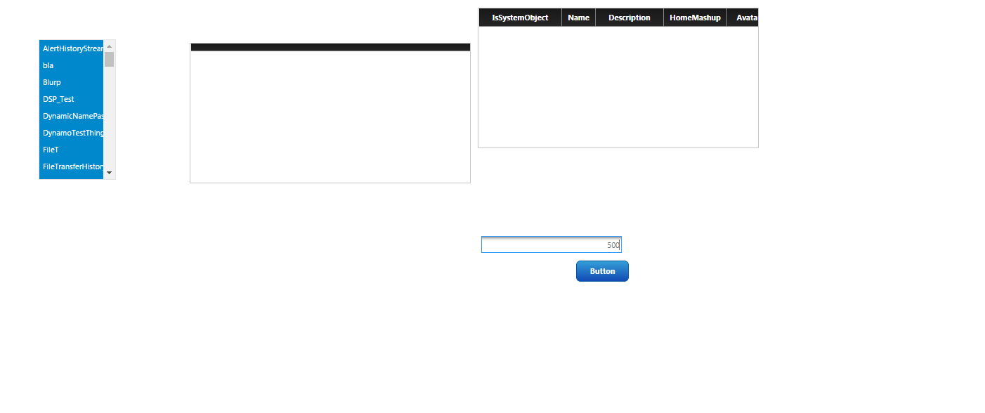

Hey guys,
How can I select all item in the list by default? Now this is what I have so far, but as you see, the selected rows in the list doesn't show anything. But then, if I change the selection, the grid is populated with the new selected item. So basically, I can select every rows by default, but the it appears like the selected rows is null. And I would need the selected rows to be All instead at default.

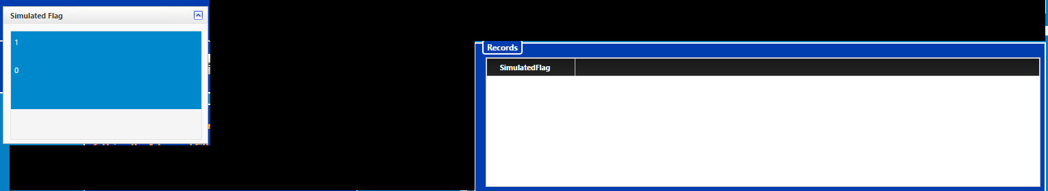

I created a Jira on this, /PSPT-3737.
I can select all items of the list at default (upon mashup loading) but they do not reflect in the grid immediately:
