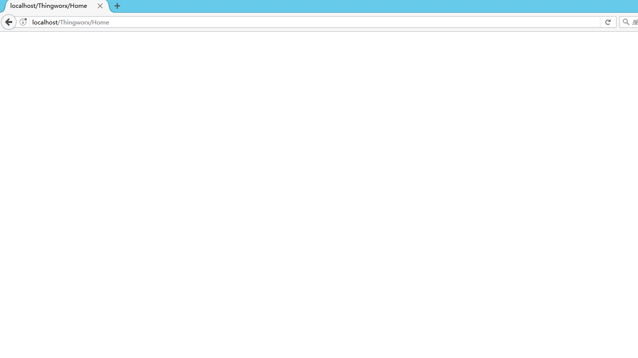

     The Thingworx platform I deployed doesn't work today.
     The version I installed is Thingworx 7.3 . And Used the postgresql 9.4 as database.
      When I used the url "localhost/Thingworx"  to visit the platform, it displays like the picture below.
