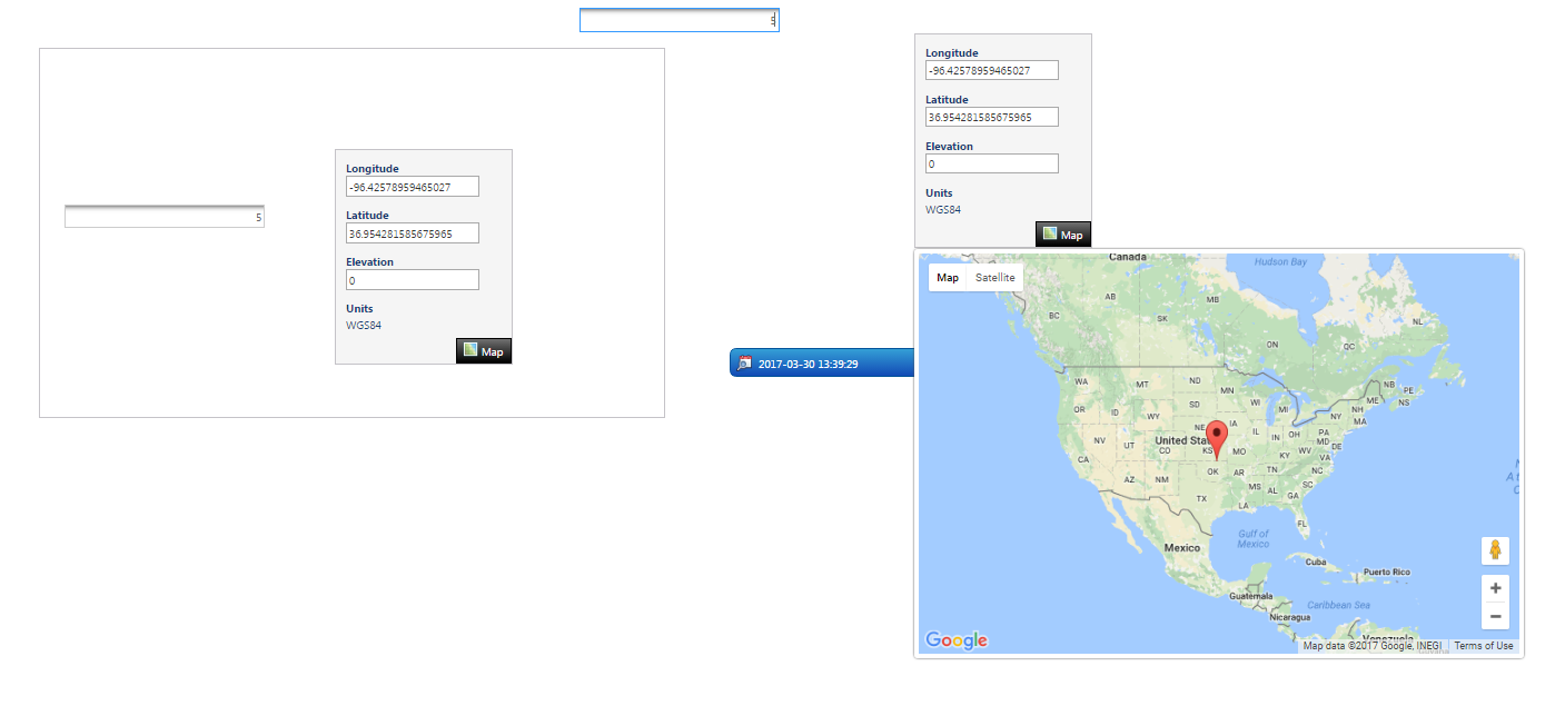

Could you please provide the details or your mashup entity to demonstrate your bindings/logic?
Have you tried passing through session variable (just as an alternative solution, if the mashup parameter problem confirms to be a bug - it needs to be fixed).
20-Turquoise
March 30, 2017

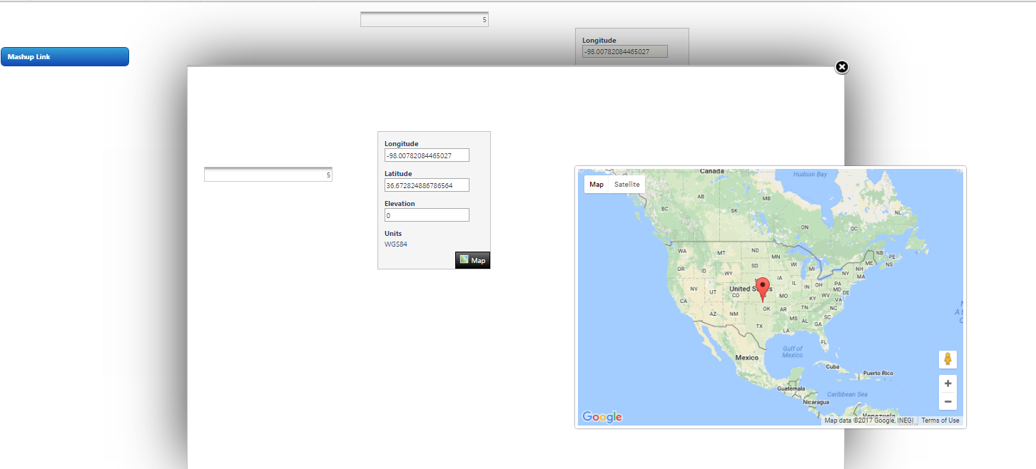

I have just confirmed that my parameters with location type are also passing properly via a regular mashup parameter method.
