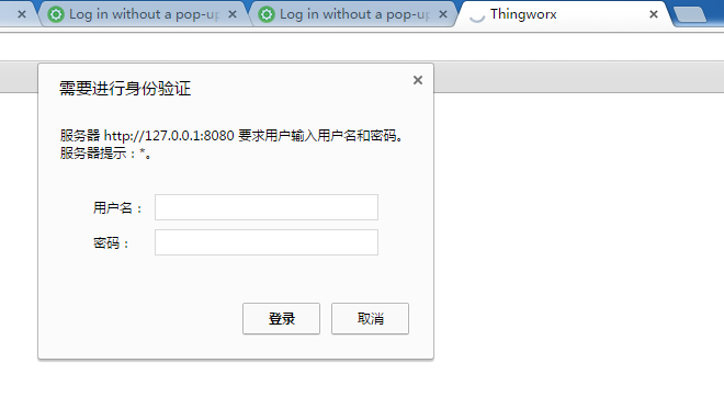

Hello everyone!
The login interface of ThingWorx is a pop-up window, and I want to replace it with a mashup.How to realize it?
Thank you!

    Hi Carles,
    Thank you for your answer!
    But after reading "Form Login Pages for Organizations" section on documentation,I didn't find the way to login without the pop-up window.
    The screenshot  is following,and it is a login pop-up window in Chinese .Is there a method that I can replace it with a mashup?
    Thank you!
    October 7, 2015
    Did you created Organizations and added Users to it?
    If that's the case, you just need to login with this URL:
    "your-server-url"/ThingWorx/FormLogin/"your-organization-name"/ and it has to show a Form Login instead of popup window.
    Also if you try just to log in with the following URL it should appear the Form Login.
