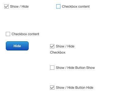

I was too quick when I replied, sorry. Here is the solution.
1) If it's ok to have a checkbox "Show / Hide" which make visible/invisible another checkbox "Content", it's a lot easier. We just need to bind the the first checkbox State to the second checkbox Visible.
2) If a button is really needed, I will still use a checkbox "Show / Hide" like the solution above. The button will change the state of this check box, with a service like this:
Service name: ShowHideComponent
Input: isShowing, BOOLEAN
Ouput: BOOLEAN
Script: var result = !isShowing
In the mashup, the input of this service will be the State of the checkbox "Show / Hide" and the ouput is this checkbox State​ too. And, the button Clicked​ event is binded to this service. Therefore, when the button is clicked, the state of the "Show / Hide" checkbox is changed, and the "Content" checkbox visible is changed. Finally, the "Show / Hide" checkbox Visible can be set to false, so the user only see the button and the "Content" checkbox.
3) Change the Label on the button when it's clicked
It's not possible to change it directly. The label is not a variable. But there's a way to create the same effect. The idea is using 2 buttons with 2 labels "Show" and "Hide". These 2 buttons will be showed and hided one after another. The user only see the same button with the label changed.
How to do it ? A third inivisible button is used to trigger this. A new transparent style is created and set to all style of the invisible button. The Z-index of this button must be bigger than these one of 2 other buttons (Show and Hide), so even it's invisible, it's on the top of 2 other buttons.
Two more "Show/Hide" checkboxes are used and two more same services ShowHideComponent are added to the mashup. The rest is the same as the step 2​. When the invisible button is Clicked, the "Show/Hide" checkbox State is changed, and the button Visible is changed too. The button with the label "Show" will be loaded with the State true and the one with the label "Hide" will be loaded with the State false. The three buttons Invisible, Show and Hide are on the same place.
Hope this help
bgray-21-VisitorAuthor
December 7, 2015
Thanks again for the options. The Radio Button widget worked great.
I like the checkbox idea too and may give that a try if I have some time.
