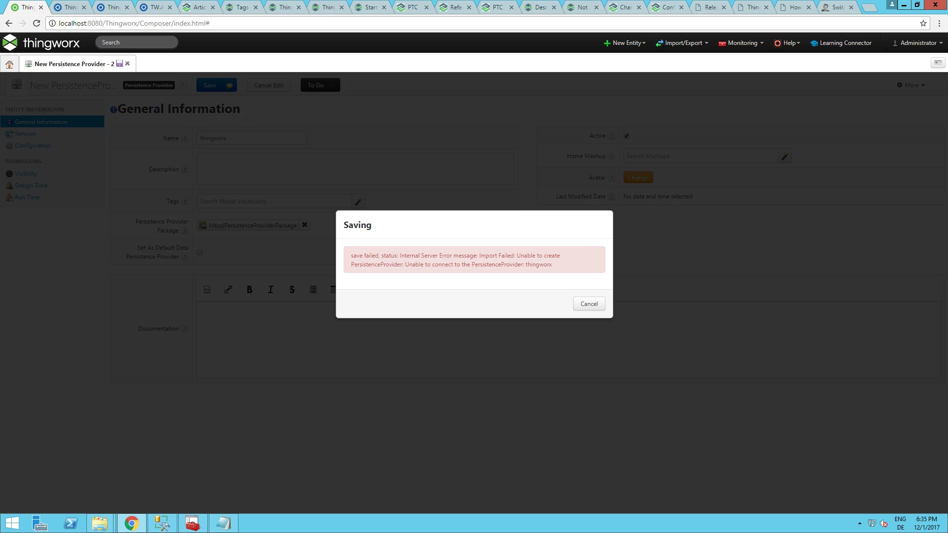

I am trying to make MSSQL Server 2014 as my data persistence provider as per the instructions provided at http://support.ptc.com/cs/help/thingworx_hc/thingworx_6.5_hc/index.jspx?id=ConfiguringaPersistenceProviderEntity&action=…  but unfortunately, I am not able to do so. I receive an error message(please see attached pic). How can I solve this error?
Also when the instructions say import the PersistenceProvide package what exactly the instructions mean by that?

Hi Tushar
I would like to step back to better understand what you are doing and if you actually need to do it.
My understanding is that you have downloaded the ThingWorx-Platform-Mssql-8-x-x media and installed it.
Is that correct ?
If that is the case the installation has already configured the ThingWorxPersistenceProvider to point to MSSqlServer.
You should be able to see it under DATA STORAGE > Persistence Providers, Advanced button tick Show System Objects.
So if you want to use one MS SQLServer there is nothing else for you to do.
You will only need to create a new persistence provider if you want to connect ThingWorx to a second different SQL Server.
Is that what you are trying to achieve ? (In which case you can probably get clues form the Configuration page of the ThingworxPersistenceProvider already created)
or are you using only one MS SQLServer ? (in which case you have no need to create a Persistence Provider.)
