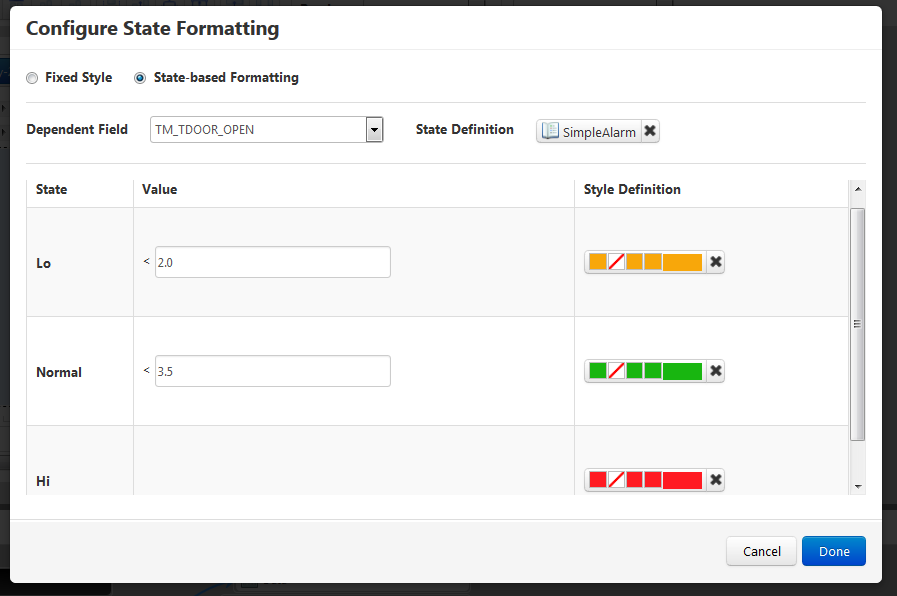

Hi All,
I used State formatting on data chart for implement 2 threshold level LOW and HIGHT.
The two threshold level LOW and HIGHT as properties of Thing, but inside the Configure State Formatting is impossibile to use property name .
How can  I do to use properties name to define a State formatting ?
Many Thanks
BR
Dimitri
Best answer by PaiChung
once you have applied the state based formatting, you'll see new Properties on your Widget, should be called State_Lo/State_Normal that you can now bind your properties to
PaiChung22-Sapphire IAnswer
22-Sapphire I
May 22, 2017
