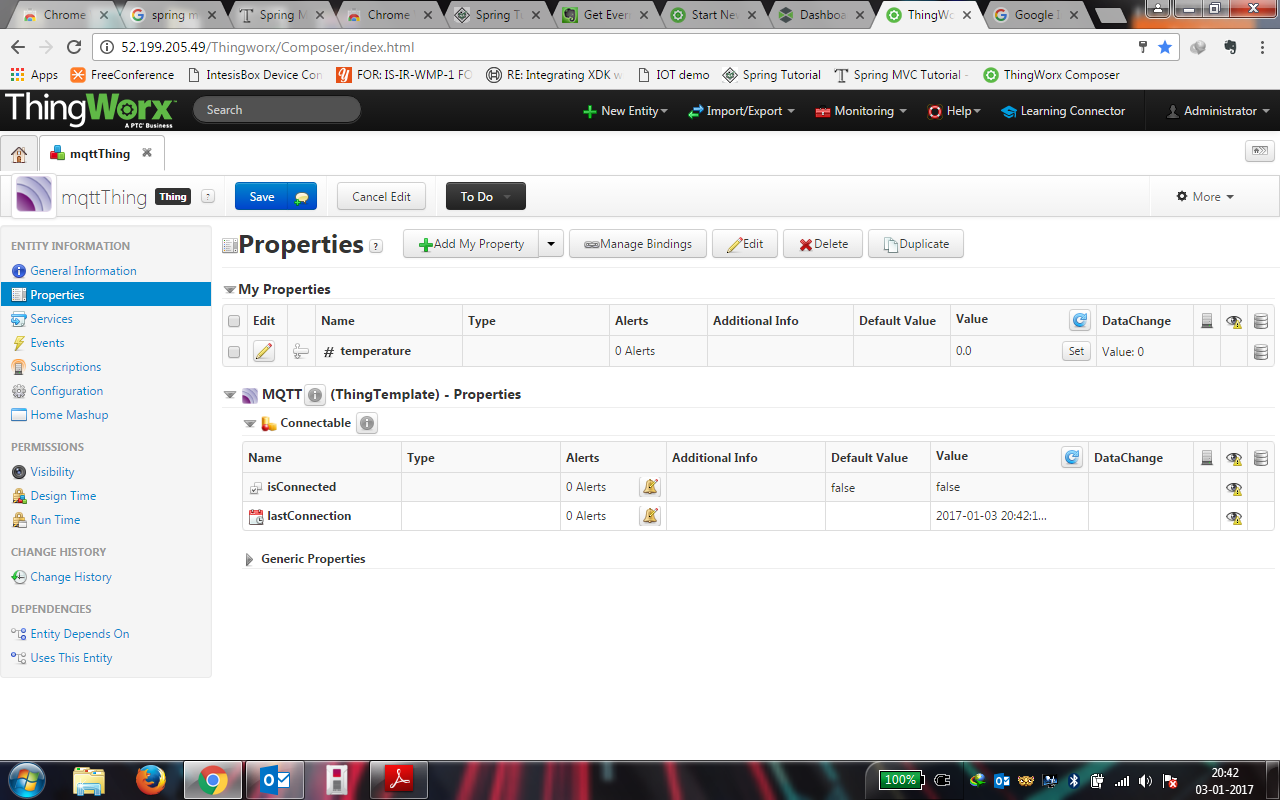

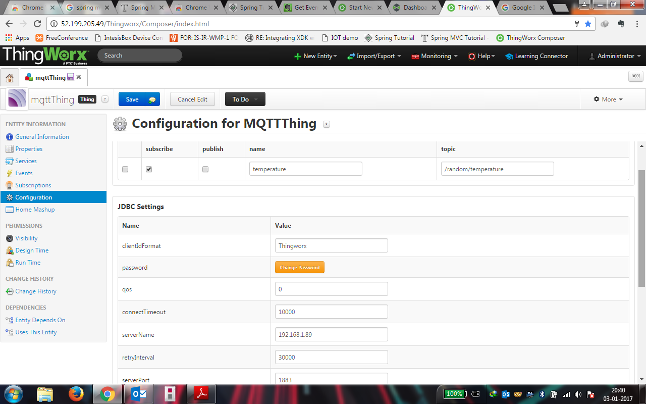

I am not able to connect with my MQTT broker, I think some issue in my mqtt thing configuration page. some one can you guide me to resolve this issue. This is my configuration page.
After this configuration this is my properties page
Thank you in advance.

Same as the TCP one, since they both are on the same machine, can you try hitting localhost instead?
January 3, 2017
Thangarasu, same as the TCP question, is this running in the same network where your ThingWorx server is hosted?
January 4, 2017
Thanks for your response Aanjan.
Yes, Thingworx server and MQTT broker both are in same network. Both servers are running in one laptop.
Aanjan5-Regular MemberAnswer
January 4, 2017
