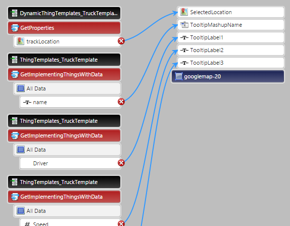

Hello Expert,
I want to create a tootip mashup on the map widget.
So, I create a tooltip mashup refer to the  below link.
https://support.ptc.com/appserver/cs/view/solution.jsp?n=CS230816​
but TruckTooltipMash isn't appear on the TruckMash map widget..
By the way I don't know how to bind the parameter exactly.
Best answer by ankigupta
This seems fine.
Also, add all data from GetImplementingThingsWithData Service to data of Google map widget and select locationfield in the google map property as location.
Also, set show markers as checked.

Just to confirm did you set the OnLoad property for these services as true while adding these Services in the mashup?
jlee-711-VisitorAuthor
April 20, 2017
Yes.
I set the OnLoad property for  GetImplementingThingsWithData Services.
By the way, Above Connection is right?
ankigupta5-Regular MemberAnswer
April 20, 2017
This seems fine.
