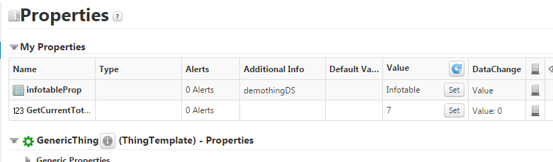

This timer fires every second and gets me the current row which I then store in a property in a Thing which contains a property persisting the infotable looks something like this. The GetCurrentTotalValue property below gets updated everytime the Timer thing is fired (which is every second) and updates the value

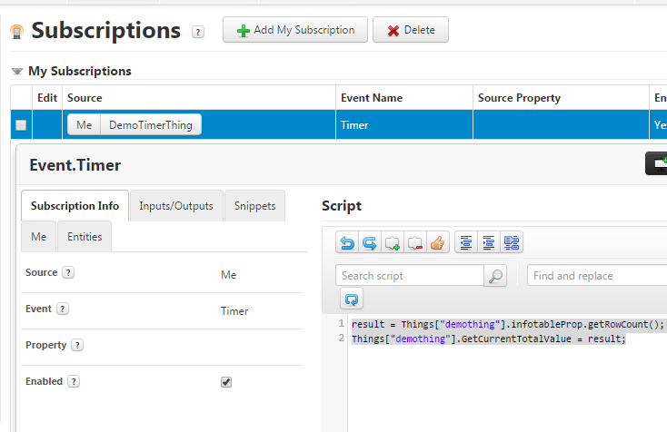

Aakash, what is updating the infotable? Can you not create an Event/Alert on that? In a crude and straight forward way you can simply create a Timer thing which subscribes to the Timer which fires every few seconds (you can configure as you feel). And in that Timer you can create a subscription which listens to itself. Under this subscription you can add your code to count the rows of the infotable and this way you have current state of the rows in the Infotable. For e.g. i added this code snippet in the Subscription like this and writes to a property GetCurrentTotalValue in DemoThing
result = Things["demothing"].infotableProp.getRowCount();
Things["demothing"].GetCurrentTotalValue = result;
This is how my subscription looks like:
Hope this helps.

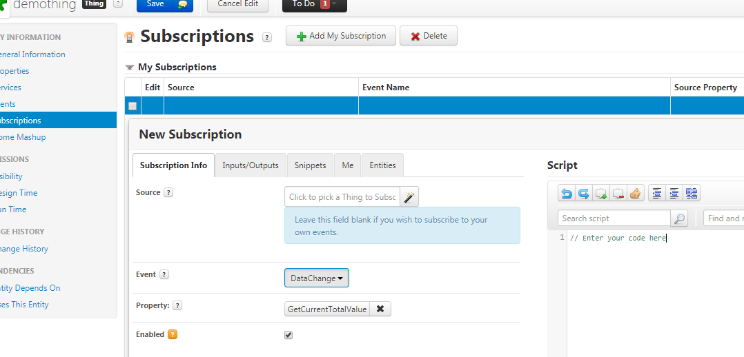

Aakash, I think your requirement to track the change of a single property isn't very different from the title of your question. Whether its a property or an infotable you are trying to track periodically. You just need an Alert/Event fired to which you can subscribe. That's how the Event - Subscription model works. So if your requirement is to simply track the change in property value then you can create a Subscription on that property which uses an OOTB Event called DataChange on GetCurrentTotalValue property and that's it. Here's how it would look when you'll configure it
Once enabled this subscription will execute the code you'll put in whenever there's a DataChange Event fired on Property GetCurrentTotalValue
