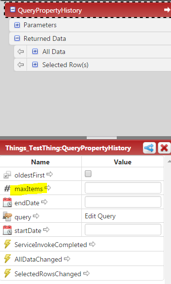

    I'm using "QueryPropertyHistory" with StartDate and EndDate from date picker widget.
    I can see maxItems in the Parameters of this function, I guess I can increase the number of values with that ? Is there an easy way to fill this query  parameter with an higher value (a constant for example) from the mashup builder ?

    ankigupta5-Regular MemberAnswer
    March 15, 2017
    We can set the default values by clicking on the Service in the Mashup Builder. It will show the Parameters at the Bottom.
    As per my knowledge; there is no inbuilt advanced Service to get average data per Hour. But we have the possibility of writing our own Services and use Query to filter data and also we can use Snippets like average for getting the average as per our requirement etc.
