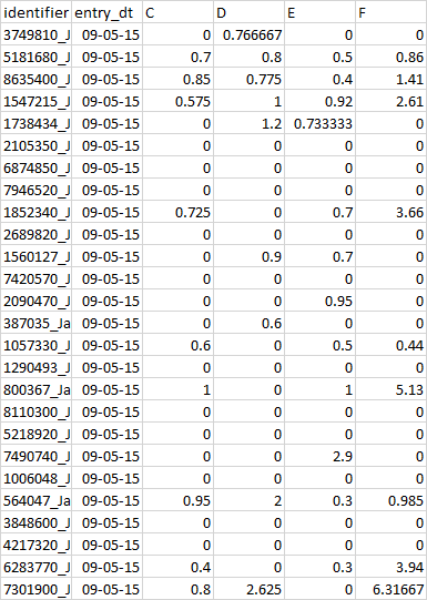

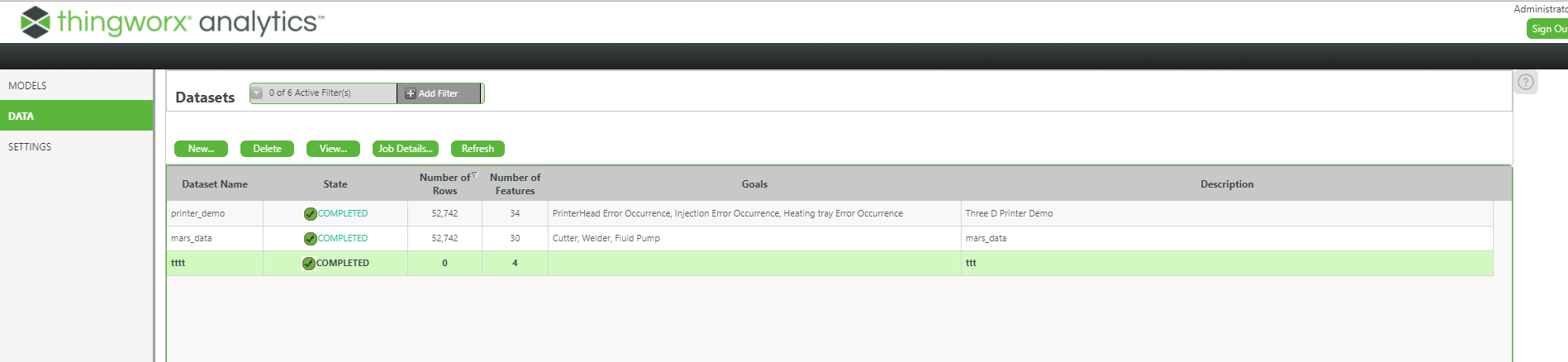

When i generate a new dataset, the number of rows tab has a value of zero
  These are CSV File and json code
        "dataType": "DOUBLE",
        "description": "C",
        "displayOnly": false,
        "fieldName": "C",
        "lever": false,
        "objective": false
        "description": "D",
        "fieldName": "D",
        "lever": false,
        "objective": false
        "description": "E",
        "fieldName": "E",
        "lever": false,
        "objective": false
        "description": "F",
        "fieldName": "F",
        "lever": false,
        "objective": false

The issue (or at least one that woudl lead to 0 rows showing) is that you have no field defined as goal in the json file.
You need to have at least one field defined as goal ("objective": true ), so that the engine knows what to predict.
Without a goal, the dataset is indeed loaded as 0 rows.
