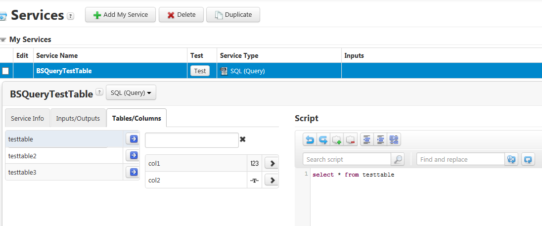

Also note that once your database configuration is correctly set in the Database Thing that the table objects will show up in the Tables/Columns tab when creating a Service.  In this example, a MySQL database with three tables.
  JDBC Driver Class Name: com.mysql.jdbc.Driver
  JDBC Connection String: jdbc:mysql://<database host:port/database name
  Fill the Database User Name and Database Password
Hope this helps.
