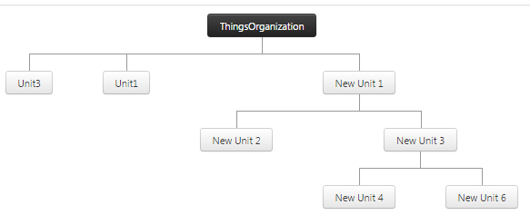

Is there a way to display the Organization trees as shown (like below example) in a mashup?
I also need to be able to view users/members and assets based on the organization hierarchy.
People in the root unit/organizational group (ThingsOrganization) would be able to view the entire organization, users and assets.
People in New Unit 3 would only be able to see New Unit 4 and New Unit 6 as well as the assets and users assigned to New Unit 4 and New Unit 6.

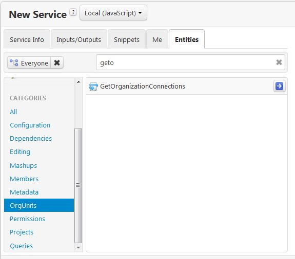

    Paul, that is a service on your Organization entity itself. For example, add a new service and choose your Organization entity in the Entities tab. GetOrganizationConnections is a service available under the OrgUnits category.

    Aanjan,
    Thanks for the quick response.  I found the service as you said.  I can test the service and it seems to work correctly when using the test button.
