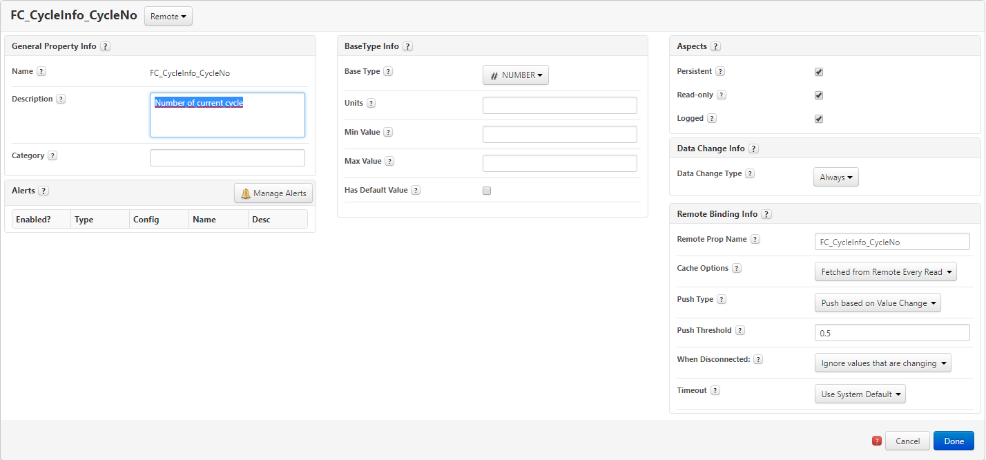

When I create the binding in my ThingTemplate this results in the following settings:

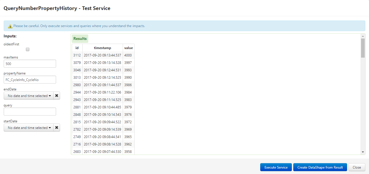

My remote device is running a cyclic process with a cycle time of about 10 seconds. I checked that the cycle count is updated by my remote device and I can see that the cycle count property in my Thing in Thingworx gets the updates if I click the refresh button in the property list of the composer.
But here is my problem, in my value stream, I get the values only on a 30 second basis.
As far as I understand this Article Viewer | PTC​ it is the remote device that pushes the data to the Thingworx instance. And this seems to work.
Can anyone please help me to understand where the 30 seconds delay between my values come from? Thank you in advance.
