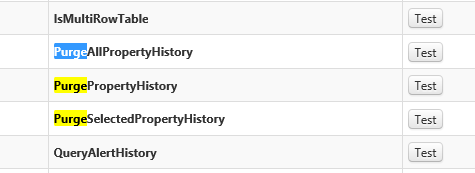

Best answer by zyuan1
These purge services are not in old Thingworx versions, this is the screenshot of 7.3.2, they have it.

zyuan15-Regular MemberAnswer
April 11, 2017
