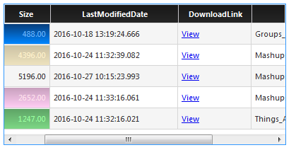

1)Here in the pic,You could see the colour differentiation. How could that be possible? I have created that table using 'Data table'
In brief, I want to set a threshold level for that column in the grid. If the value exceeds my threshold level , I want the color to be changed.
Explain me from the scratch..

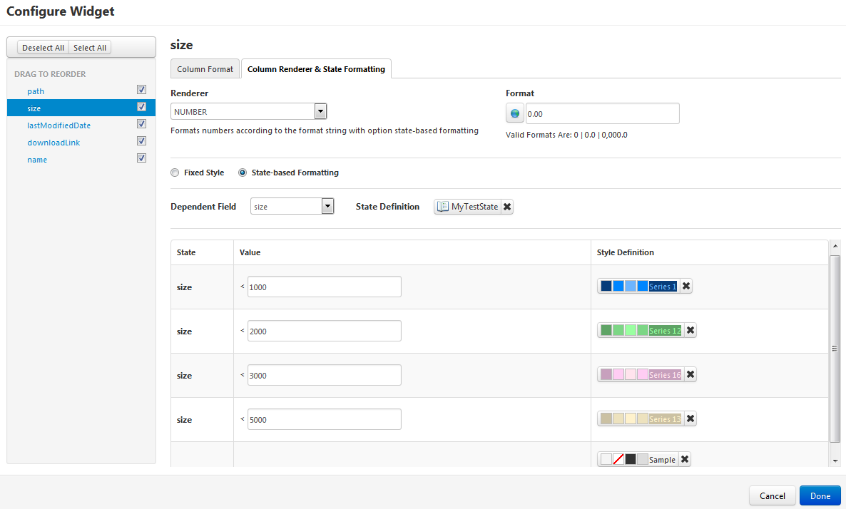

Hi Bavithraa, did you already try the State Based formatting for this, with that you can apply different styles based on certain rules. Please check this documentation for more detail : Style and Sate Definitions
Hope this helps.
February 28, 2017
Hi Bavithraa Marimuthu​,
In the Grid->top-left->Drop down -> click on configure Grid column.
For each column you can go to Column Renderer & State Formatting tab and change the the format to State-based Formatting.
Set the dependent field and setup the Style. Here you can define the cases to set the style for various data case.
Do let us know if you face any issue.
I hope it helps.

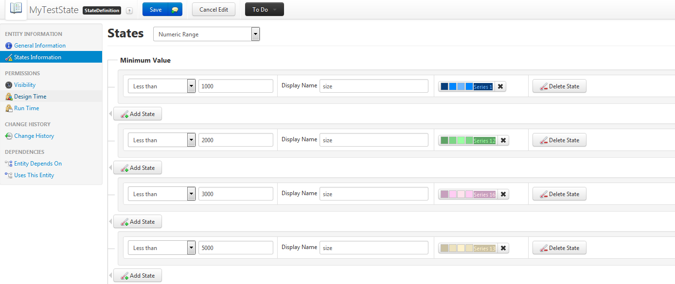

liliu5-Regular MemberAnswer
February 28, 2017
Hi Bavithraa,
My sample about states and grid widget
By the way, button widget is easy to use, if you can give us your use case, I can set up a sample for you later.
Lily

How can I set values for "maximum value " in state definition?
March 1, 2017
Bavithraa, if i understand you correctly, maximum is already defined when you are defining the numeric range as you only have two options to choose from
1. Less than
2. Less than or equal to
