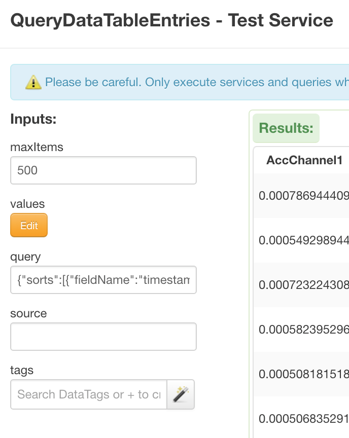

Hi Guys,
I am dealing with one issue that drives me crazy.
I have a DataTable. I am storing data into it as they come. For some reason they are not sort by the Key (it is a timestamp).
So I would like to sort it with following query (property, datatype: Query):
If I test the service manually, it works as expected - results are sorted  (with sorts and with filters as well):

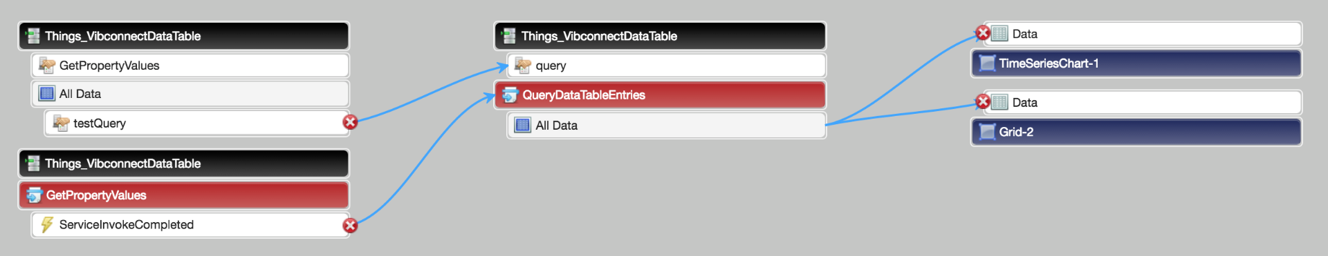

But When I try to do it via mashup, it does not seem to work. Result is not sorted. I have also try it via DataFilter widget - that does not accept Sorts queries (Filters seem to work fine).
Is there some special format which I should use so I can bind Query properties directly to QueryServicesParameters?
I would like to avoid to create a special service which takes the Query property and calls normal QueryDataTableEntries. I have lot of mashups which I am using standard service and it would be a pain to change it all.
Thanks.
Best answer by tcoufal
It turns out, that is better to write a service which fills your query instead of writing it directly via SET button.
This is my fillQuery service:
var query =
    "sorts": [
            "fieldName": "timestamp",
            "isAscending": false
    "filters": {
        "type": "And",
        "filters": [
                "type": "GT",
                "fieldName": "AccChannel1",
                "value": "0.05"
                "type": "GT",
                "fieldName": "AccChannel2",
                "value": "0.05"
me.TimestampDescendingSortQuery = query;
This resulting to:
{"filters":{"filters":[{"fieldName":"AccChannel1","type":"GT","value":"0.05"},{"fieldName":"AccChannel2","type":"GT","value":"0.05"}],"type":"And"},"sorts":[{"fieldName":"timestamp","isAscending":false}]}
Assigning query variable to query Property does something on formatting level..
