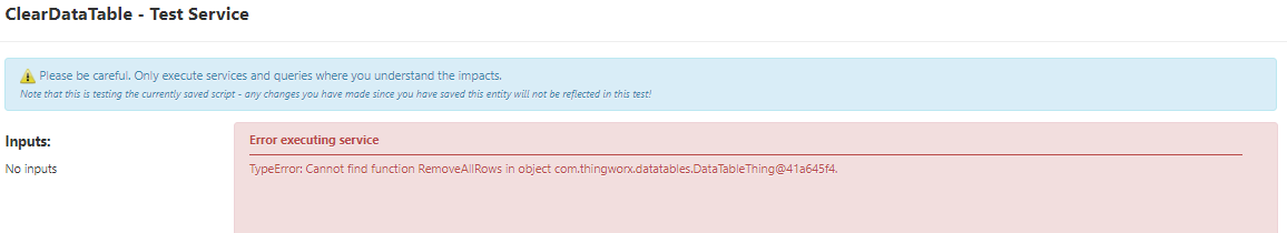

I'm trying to make a service on a Database thing where it clears all the entries of itself.
I tried using the me.removeAll(); but I get the following error:
Thank you for your help in advance.
In the DataTable thing, there is a generic service called PurgeDataTableEntries that should work
