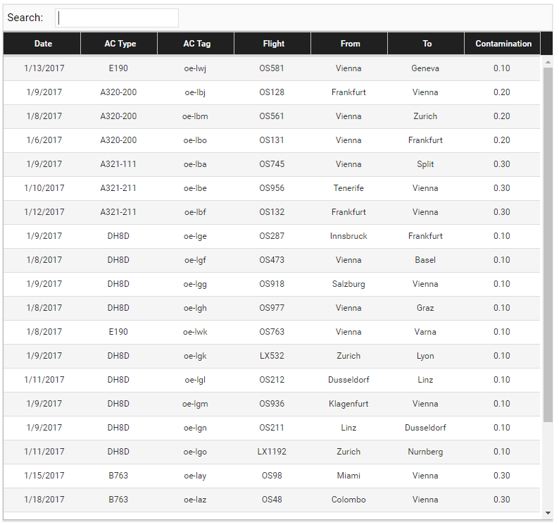

Hey there,
I have an advanced grid filled with data in my mashup and what I want to do is to find a specific entry in that grid. The data the grid is filled with is not based on a data table, but on multiple instances of a ThingTemplate. I have already ticked the EnableGridSearch property and positioned the searchbox in the mashup.
But I do not know how to operate with the QueryFilter-property.
I have already read the Advanced Grid User Guide but it does not really help me to implement it because I am not familiar with the query parameter and query services at all.
My grid looks like this at the moment and want to search for a specific AC Tag:

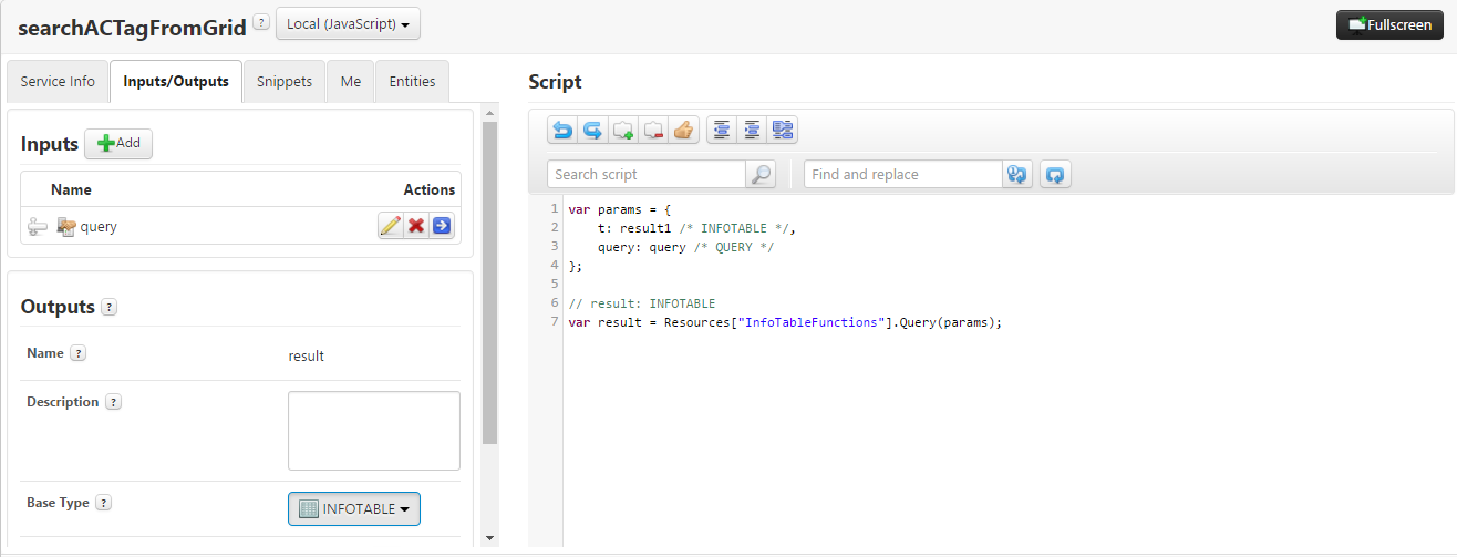

As you suggested, I have created a custom service like this:

I was actually suggesting you to update your custom service and add the code at the bottom.
I have attached my entities here; please check and let me know if you face any issue.
