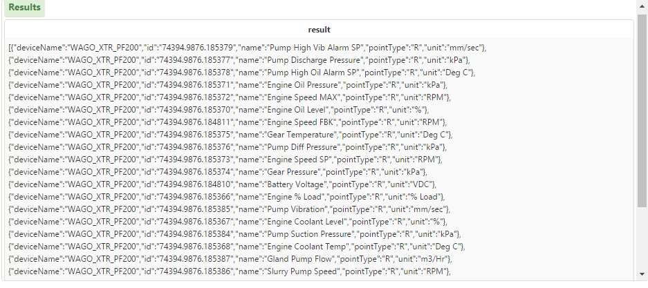

Hi guys,
I have created a service using GetText() method and able to see in Text format. Which service need to get the same output in InfoTable ?
Here is the json script and output.
var restParams = {
  proxyScheme: undefined /* STRING */,
  headers: undefined /* JSON */,
  ignoreSSLErrors: undefined /* BOOLEAN */,
  useNTLM: undefined /* BOOLEAN */,
  workstation: undefined /* STRING */,
  useProxy: undefined /* BOOLEAN */,
  withCookies: undefined /* BOOLEAN */,
  proxyHost: undefined /* STRING */,
  url: "https://api.netbiter.net/operation/v1/rest/json/system/XXXXX/live/config?accesskey=XXXXXXX" /* STRING */,
  content: undefined /* JSON */,
  timeout: undefined /* NUMBER */,
  proxyPort: undefined /* INTEGER */,
  password: undefined /* STRING */,
  domain: undefined /* STRING */,
  username: undefined /* STRING */
// result: TEXT
var result= Resources["ContentLoaderFunctions"].GetText(restParams);

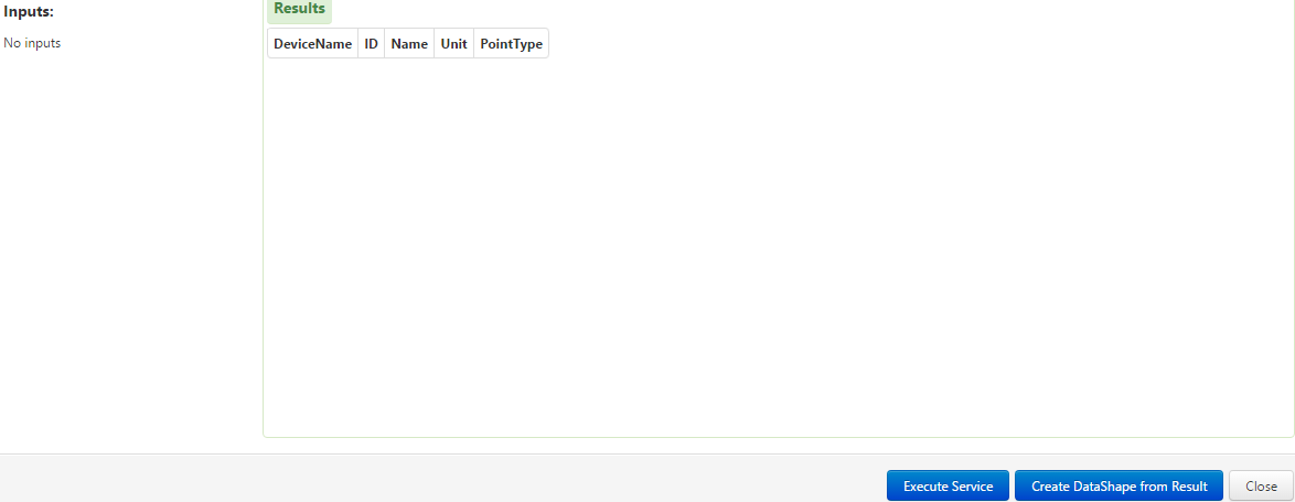

March 16, 2017
Hi Polina,
I have tried this before but it shows me as a blank in the table. Let me try once.
Hemanth kumar
March 16, 2017
Hi Polina,
Thanks for your reply. Here is the code I have tried and output as shows below.
var restParams = {
  url: "https://api.netbiter.net/operation/v1/rest/json/system/XXXXX/live/config?accesskey=XXXXXX" /* STRING */,
// result: JSON
var data = Resources["ContentLoaderFunctions"].GetJSON(restParams);
var params = {
infoTableName: "InfoTable" /* STRING */,
dataShapeName: "BoosterLiveDataShape" /* DATASHAPENAME */
// result: INFOTABLE
var jsonTable = Resources["InfoTableFunctions"].CreateInfoTableFromDataShape(params);
for(var i=0;i<data.length;i++)
jsonTable.AddRow({DeviceName:data.array.deviceName, ID:data.id, Name:data.name, Unit:data.unit});
result = jsonTable;
Hemanth kumar
