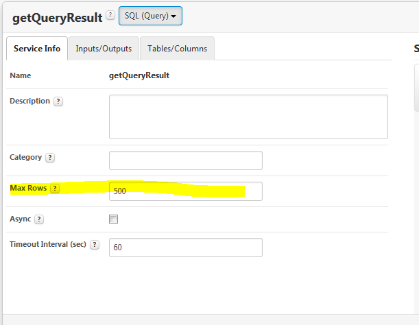

Hi Ponomarenko,
If you are returning InfoTable in your SQL Query, you will see in the "Service Info" tab of your service, there is an input of "Max Rows", which will allow you input a bigger return items number as you want:
