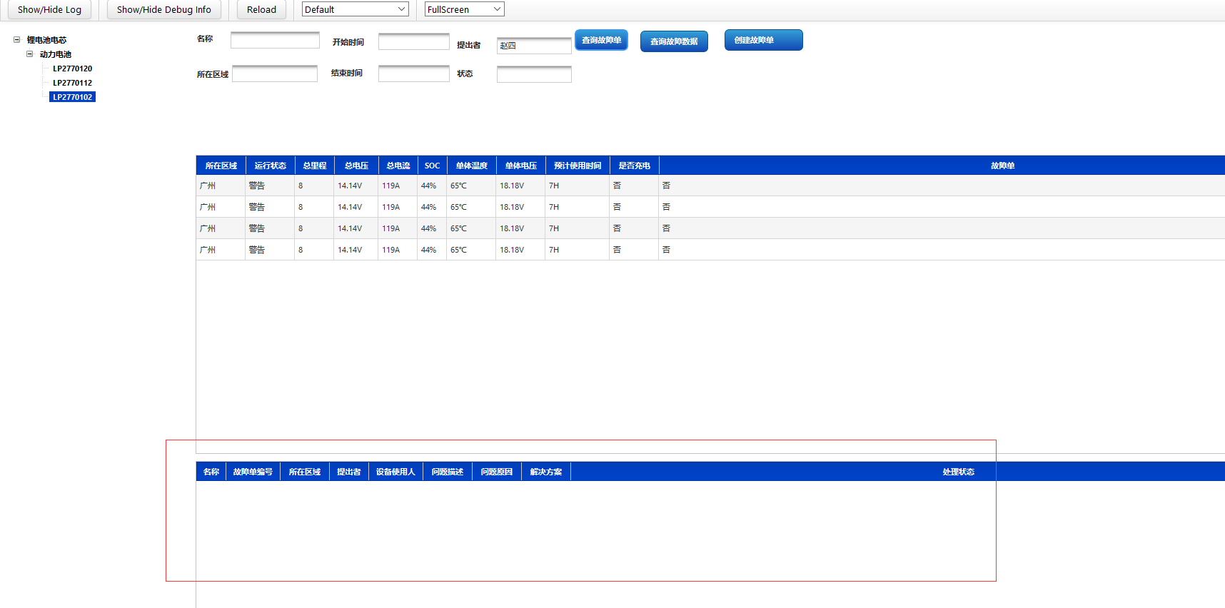

The custom service:
var query3 =
    "filters": {
        "type": "OR",
        "filters":[
                "type":"EQ",
                "fieldName":"mingchen",
                "value":mingchen
                "type":"EQ",
                "fieldName":"suozaiquyu",
                "value":suozaiquyu
                "type":"EQ",
                "fieldName":"tichuzhe",
                "value":tichuzhe
var params = {
oldestFirst: undefined /* BOOLEAN */,
maxItems: 3 /* NUMBER */,
endDate: undefined /* DATETIME */,
query: query3 /* QUERY */,
startDate: undefined /* DATETIME */
// result: INFOTABLE
var result = Things[thingname].QueryPropertyHistory(params);
Best answer by liliu
Hi Mr. Guo,
QueryPropertyHistiry serivers works fine, it's your data issue, as we checked the firs 3 records are empty. That why we cannot search out the data.
Lily

Hi Mr. Guo,
I checked your code, seems to be fine. I guess it's the service QueryPropertyHistory's issue. I will test and let you know the test result.
liliu5-Regular MemberAnswer
April 20, 2017
Hi Mr. Guo,
Lily
