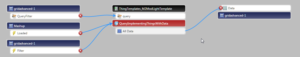

I'm using the new extension "grid advanced" in release 1.1.1 with a getImplementingThingsWithData service
I'm using Thingworx 7.3.2-b42
The widget works fine except for sortinG.
I have activated the sort option into the widget.
I can see the small triangle to sort a column but the grid is not refresh when using it.
Is there something to bind or to do to have it working ?
Best answer by posipova
There should be example entities  that are included in the package - please see the bindings. The sort feature needs a query to perform the sort.
pjoly1-VisitorAuthor
April 3, 2017
Hello
I bound the queryfilter to my QueryImplementingThingWithData query + filter action on this service and it works
