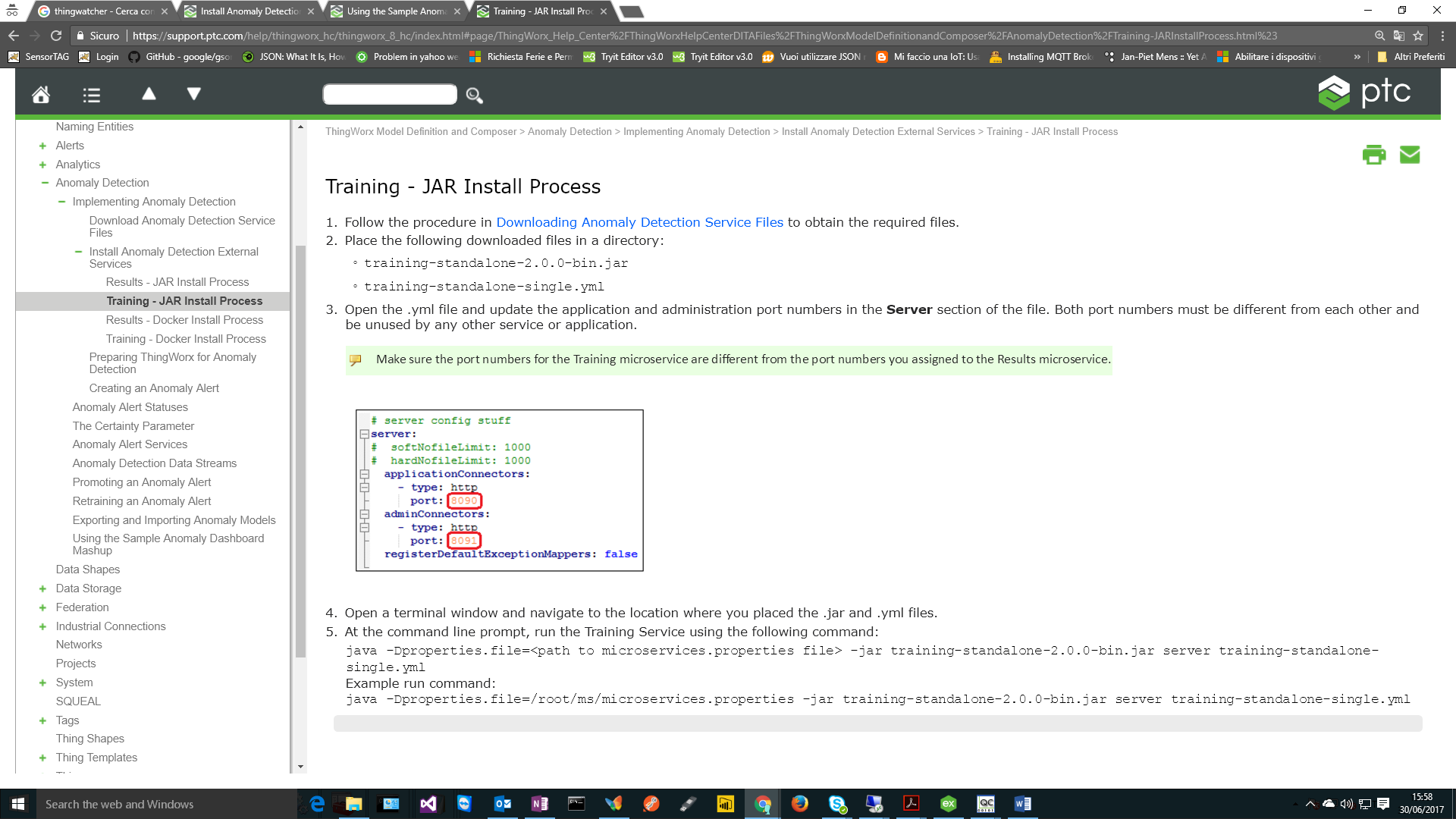

I have a problem with the Training .jar  installation.
I followed this:
I have this error:

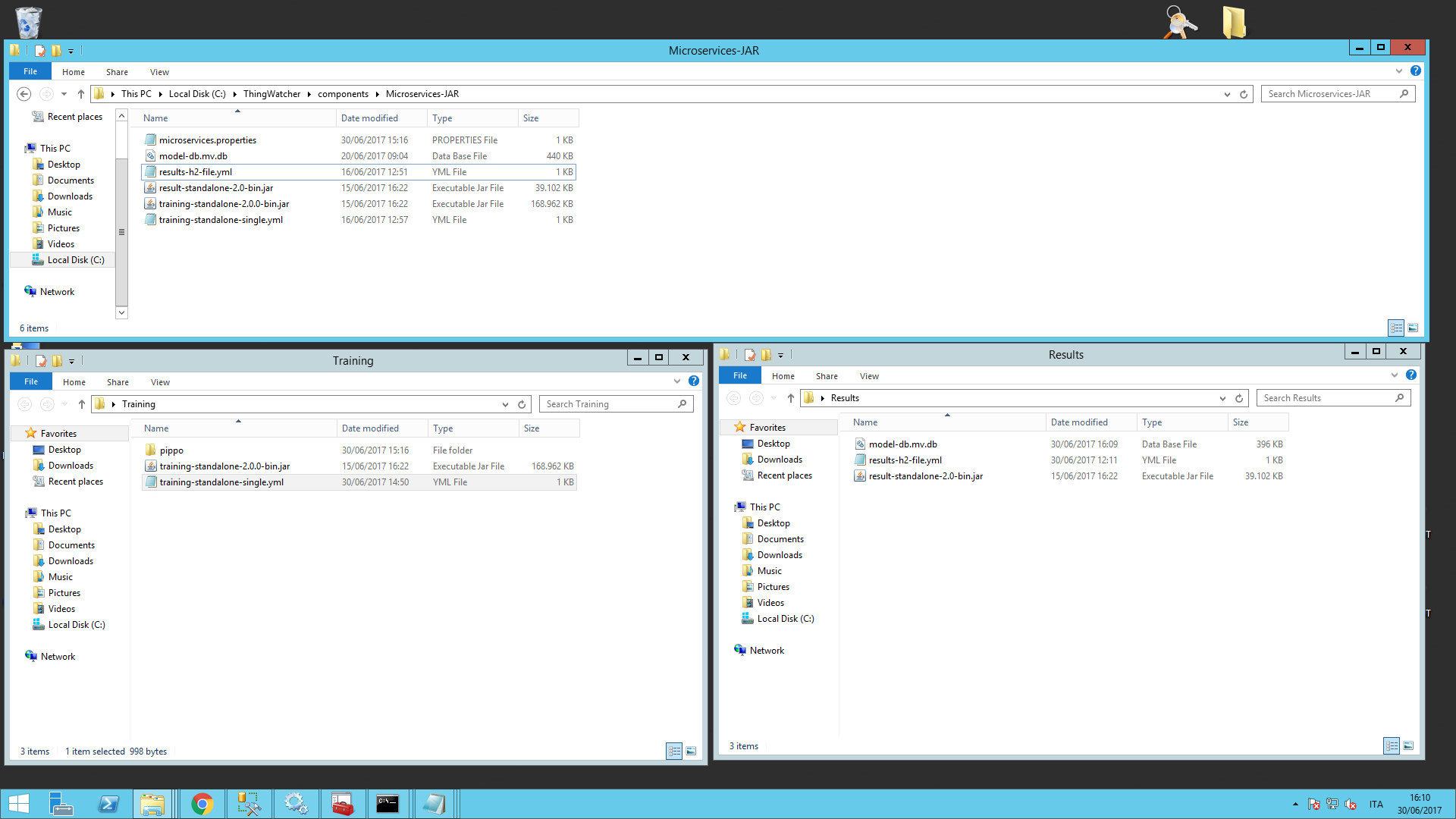

My configuration:
microservices.properties:
results.destination.uri=results://localhost:8096/results/models
file.storage.path=C:\Users\Gabriele.Brentegani\Desktop\Training\pippo

training-standalone-single.yml
appCtx:
  - "classpath:/spring/job-executor-asynchronous-memory-results.xml"
  - "classpath:/spring/service.xml"
  - "classpath:/spring/defaultmodelsource.xml"
  - "classpath:/spring/modelHealthCheck.xml"
  - "classpath:/spring/datasource.xml"

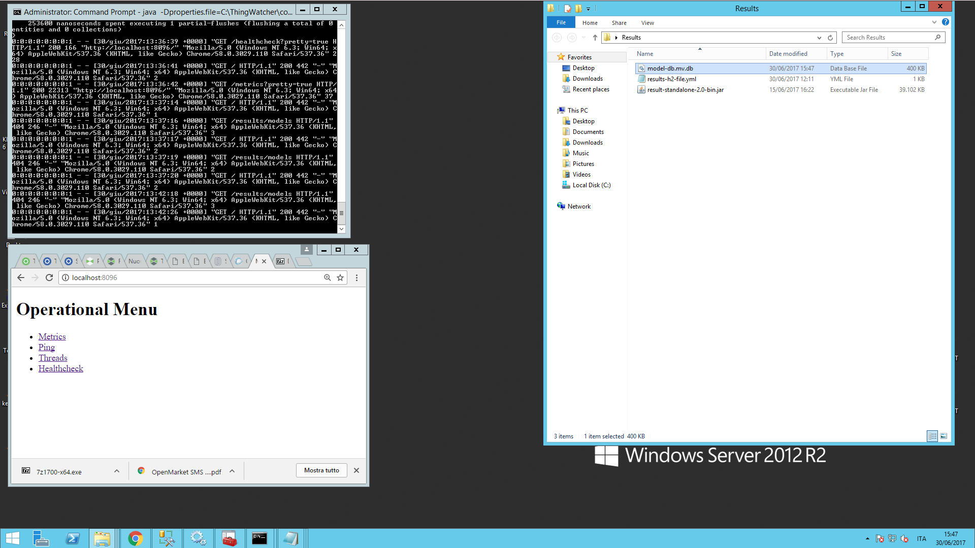

PS: The Result part works fine:
